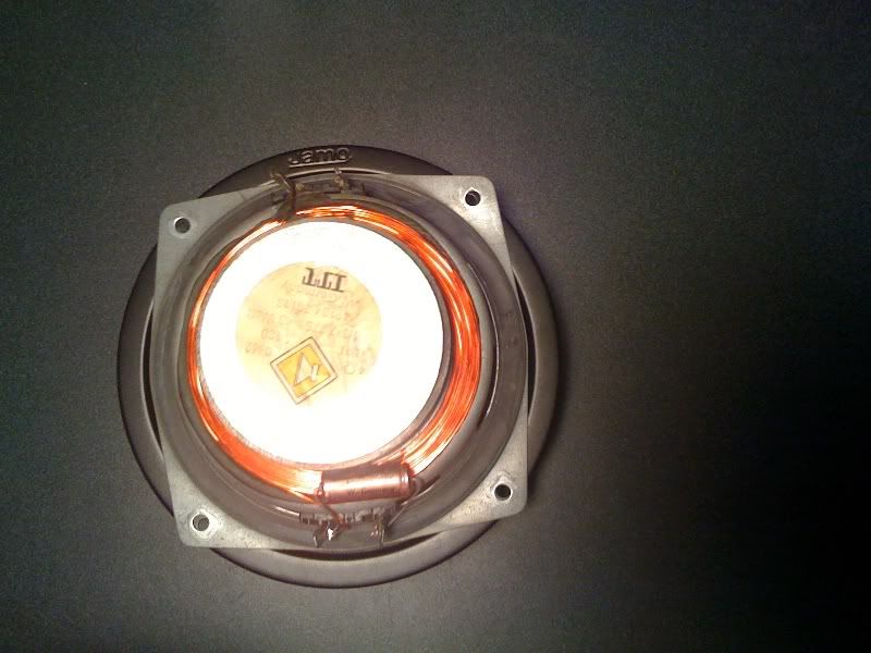

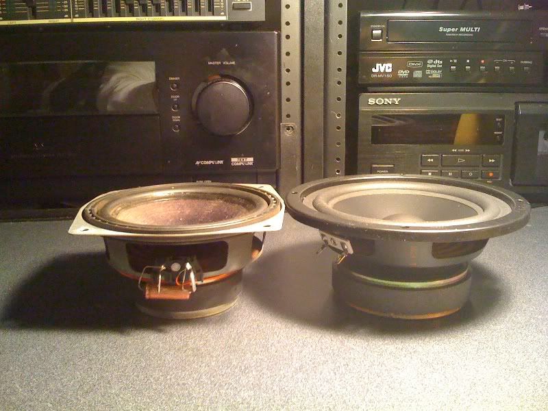

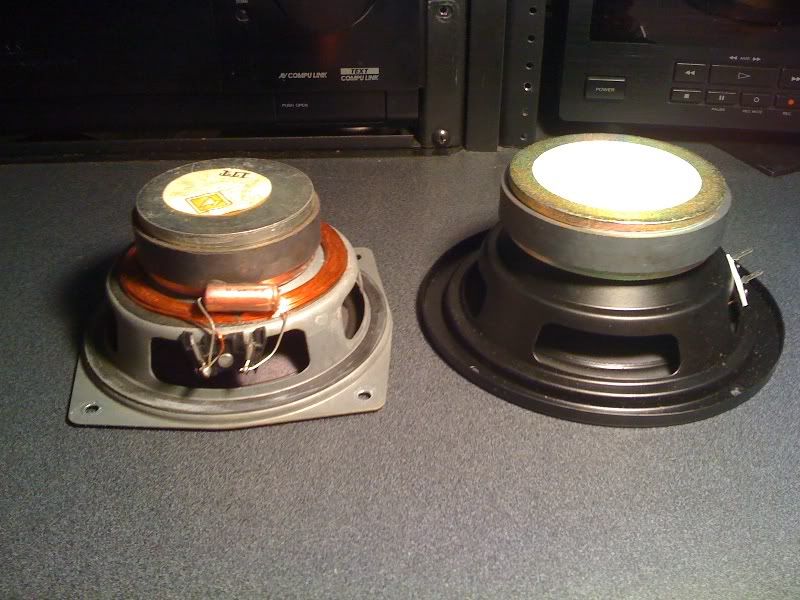

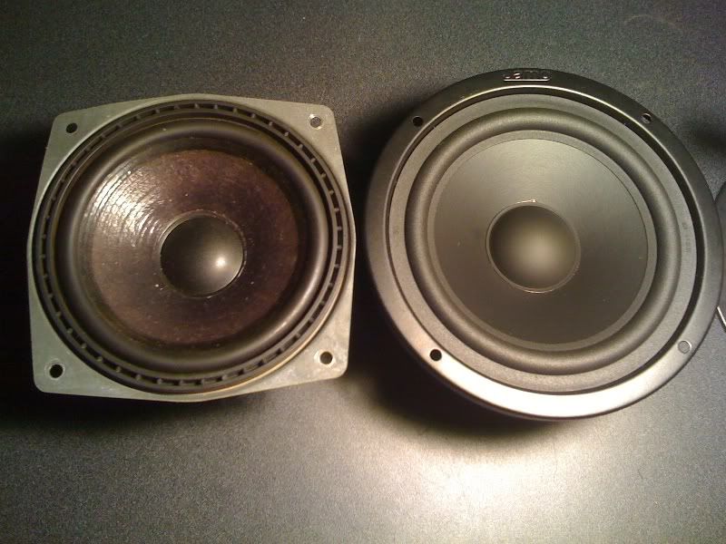

    Speakers came in today. First impression: they have an impressive heft, and look to be assembled well. Not that that means anything with regards to sound quality. If they sound as good as they are heavy, I'd be satisfied.
    Originally posted by 318Joe
    ...but for $12 why not? .
    Ok, well for starters, they are not car speakers, so while that has little impact on the speaker itself (all other things being equal), Mounting and channeling the proper frequencies to them must be addressed. In addition, the speaker lugs are of the narrow type, like what is used on the negative side of the factory speakers, so some cutting and splicing of your speaker leads, or soldering of larger lugs on the speaker is needed. All this is a long winded way to say they are not plug and play.
    First the mounting: These have a reverse lip. Car speaker mounting flanges usually fold up, away from the magnet side, and come with some sort of gasket material (usually cardboard) for backside mounting. These fold toward the magnet, giving a raised steel edge aroung the perimeter on which the manufacturer has embossed "JAMO". Very suave, but unfortunately leaves us no flange with which to surface mount the speaker, nor does the speaker come with any gasket material for mounting front or back. The edge of the stamped steel basket is what would contact the steel of the front kick panel. Its not an insurmountable problem, but it is worth noting. Both of these shortcomings are visible on the photos at the Parts Express page if you look closely.
    *correction* There is a flat flange with which to surface mount the speaker, the outside of the flange is just different.
    Frequencies: Parts express published specs on their website, 80watts RMS, and 40-3500hz. So I will have to make a custom crossover. I was planing on using the factory tweeters for now. Factory used a 3.3uf cap, and it is an 8ohm driver, so I will start there, unless anybody has already invented this wheel and wants to chime in.
    Here they are compared to factory premiums:
