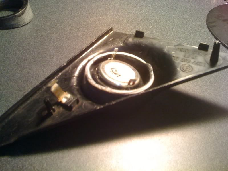

    Seems the speaker pod is a 4 piece affair: Pod, speaker, mounting ring and grill. One speaker came out alone, the other brought the mounting ring out with it and refuses to this day to let go of it. So, I have one pod with a mounting ring and one without. I figured I would deal with the difference in depth on the speaker mount.

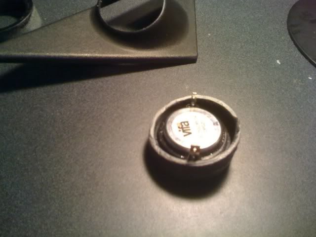

    The vifas are bare tweeters, no mounting holes or protection, so I needed to come up with a way to mount them in the oem pods. I found a pvc reducer fitting in the electrical section at Lowes that has a 2" OD, a 1.5" inside diameter, and a 1.25 inch opening at one end. Looks like this:
    It holds the vifa perfectly, and the recess on the reducing end is just deep enough to protect the dome. I had to sand down the OD a bit as the pods are just under 2" ID, and cut the excess off the back. I also sanded down the reducing opening to make the edge softer. To cope with the mounting ring, I shaved 1/8" off the face of one with a power miter saw to compensate for the depth difference. To do this I attached the reducer fitting to a much larger piece of PVC tube (Be very, very, careful with the power miter, unless you find having a nickname like "Three fingers" appealing). It took much less sanding of the OD to fit than the side without the mounting ring. A dremel with a sanding disk makes trimming the OD pretty painless - I used a razor and sandpaper.

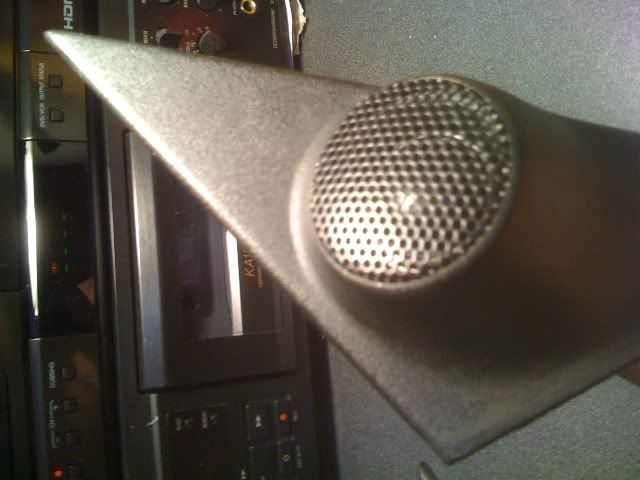

    The tweeters drop in like they were made to:
    and test mounted in the pods:
    This is the pod without the mounting ring
    Now I just need to hot glue it all together and give it a test drive

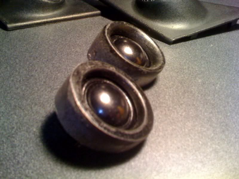

              Difference in mounting adapters; shaved in the foreground
              Also, you can see how the OD is sanded on two sides to fit

                              In this picture, the bottom pod has the factory mounting ring left in, the top pod's mounting ring came out with the tweeter.
                              The difference is about 1/8th inch of available mounting depth...
