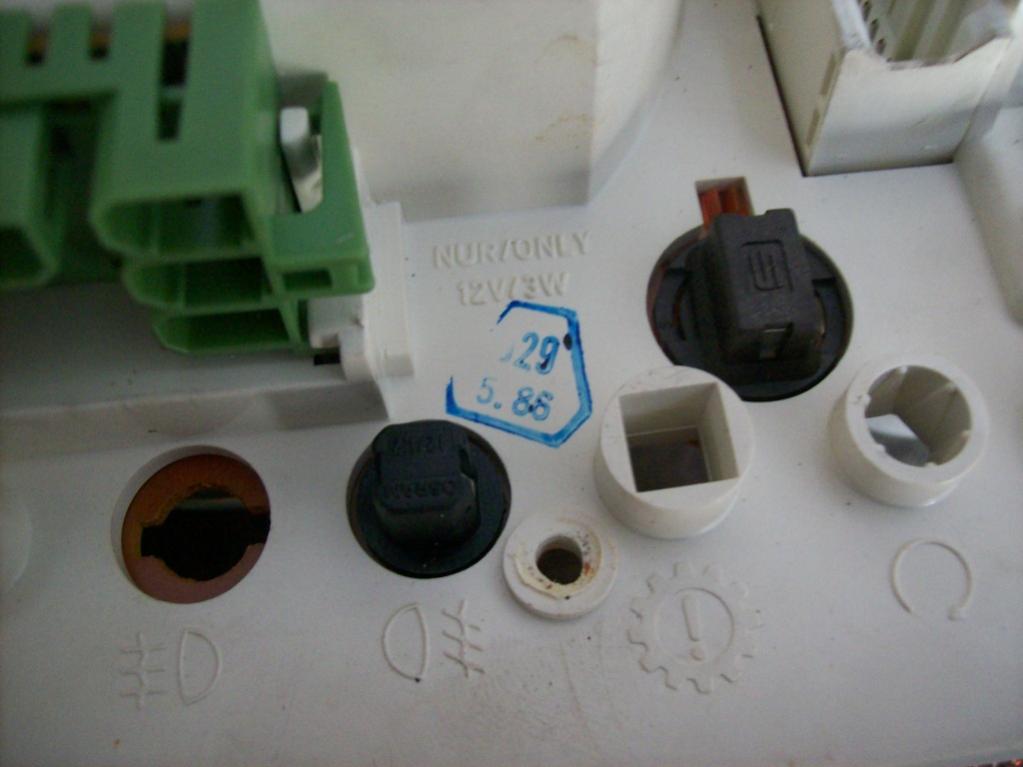

    Ever since I got this car I have been having trouble with the speedometer. It usually works for a while after start up until something knocks it loose. I have sourced the problem to the bulb that you plug into the back cluster. Basically if I out my hand on this bulb and press it into the cluster hard when I am driving it works, and stays working until I hit a bump or something seems to jar it loose. The bulb seems to be soldered into place and is not burn out. Are my wires just bad and need to be replaced or do I need a new bulb?
    Any help would be greatly appreciated.
    Pics for clarity:
    The "bulb"
    And it Plugs into the hole on the far right side in this pic:
    That bulb has nothing to do with speedo/odometer... probably wouldn't hurt to fix that ugly mess though.
      That's what I though the every time I push it in when the speedo stops, it starts working when you push it an hold it in. I'll play around with some of the other wire tomorrow and see. Thanks for the reply
        Must be something else happening when you push that bulb in, take the cluster out and inspect everything.
          Sounds like you are closing a broken solder point or tracer when you are pushing that bulb in. See if flexing the back plastic has the same effect as pushing that bulb in.
