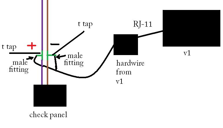

        What method should I use once I identify which wire to use.
        Something like a t tap?
        and then crimp a male fitting on the positive and negative
        sorry for the preschool wiring schematic

          Yup that will work just fine.
