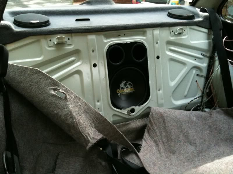

    Finally getting around to doing audio in my E30 and would like some input/review for components. My main questions lie around the rear speakers - I currently have factory premium sound , and I'm not sure what to replace those speakers with. Also of note, I currently have a Kenwood KDC-MP638 head unit and factory amp delete.
    My buddy is trying hard to sell me on a pretty much complete Infinity Reference setup, and I don't know if I'm getting good components with them or not. Anyway, onto the list:
    Subwoofer enclosure: StereoInstaller1's 10" box
    Subwoofer: Infinity 1060W
    Rear Speakers: Infinity 5032CF
    Front Speakers (+tweeter/crossover): Infinity 5030CS
    Amplifier: Infinity 5350A
    Headunit: Kenwood KDC-X994 (this is already on its way to me as a factory refurb via Crutchfield)
    Amplifier Kit: Absolute KIT-4 4 Gauge Amplifier Kit
    Does this sound like a decent setup? I'm not looking to spend mega bucks on this, just get a really good, clean sounding setup. Obviously I'll need speaker wire as well, inputs on that?
    Thanks in advance to all.
