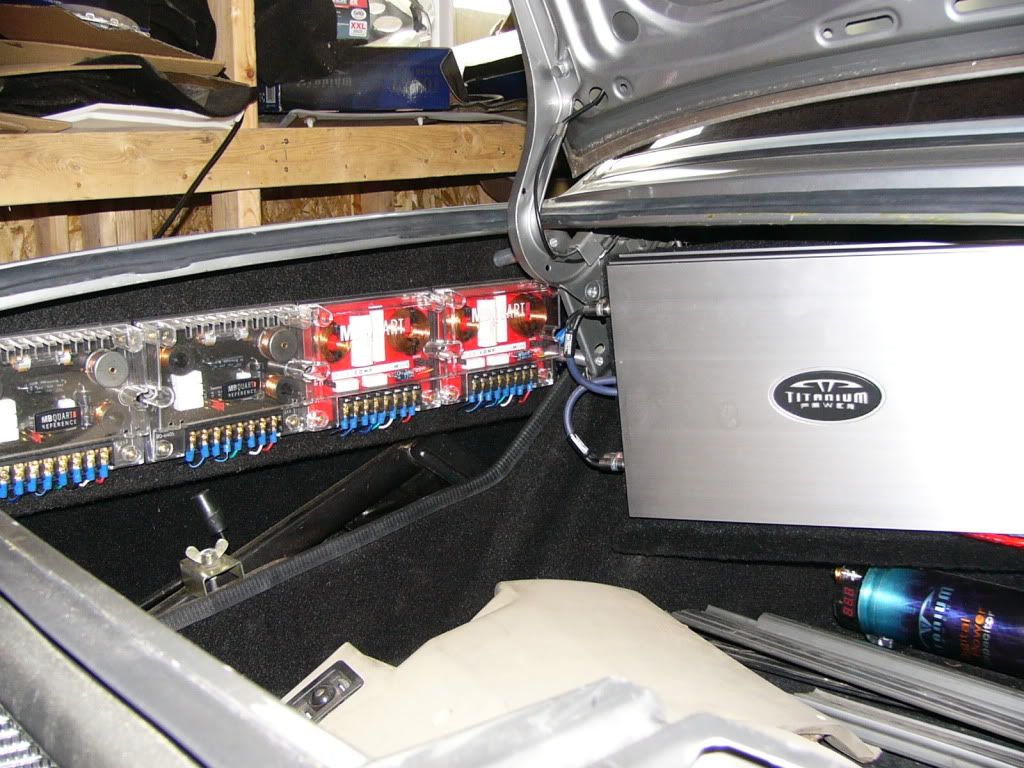

    This is a big stupid project I have been working on. This is just a tiny bit of the whole thing. This is the passive crossovers for the front and rear speakers. There are multiple channels of power with separate crossovers before the amps as well. The power cable for this install is more than most people spend on their speakers...

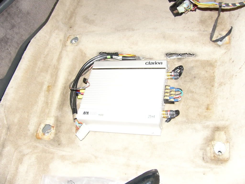

    The floor, before:
    4 Passive crossovers, tri-amped, and Bi-Wired:
    3 amps (100RMS X 4 @ 4 ohms on mids and tweets front and rear, 1200 WRMS on a single 12" prototype woofer)

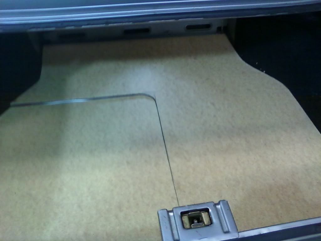

    Test Fit:

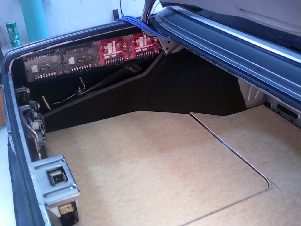

    Still not finished, but functional:
    I have well over 200 hours into this car so far. EVERYTHING has been a total pain in the ass, from making sure the jack can be removed from under the crossover rack to custom built RCAs, and masses of them!

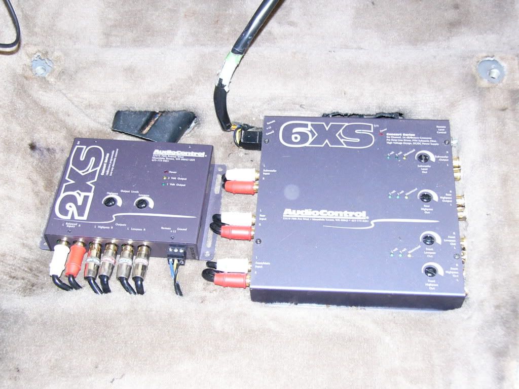

    The 2XS is for the center channel and its amp only...wanna talk about overkill?

            Actually, I really wish I had taken pics of this box. The floor of the E28 is not flat, it has a big (4" D X 6" H) metal "step" on the front wall of the trunk. That box is taller than the opening of the trunk, and the step in the front of the angled part of the box was damn near impossible to build...but that damn 85 pound box has to be wedged and slid into place. Fortunately, I was also able to keep the shock mounting bolts accessible, hopefully that box will never need to come out!
