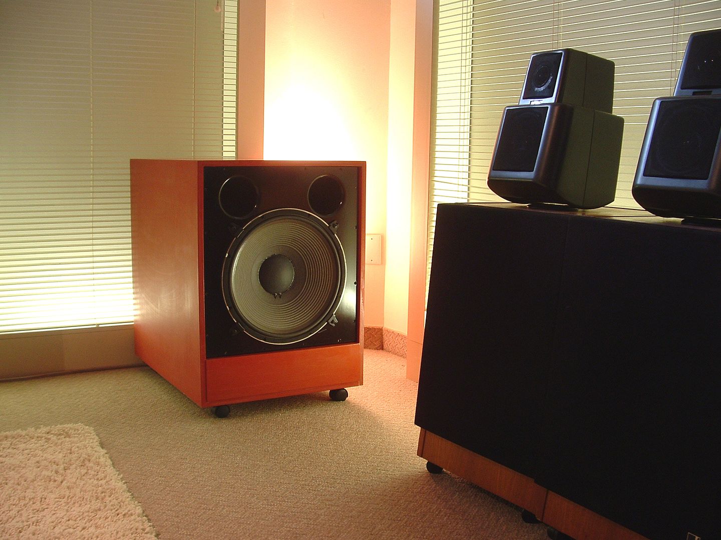

            Eh, eh. I just made a prototype sub for home, using JBL's legendary 15" 2235h in a 6.9cf enclosure. I made two ports of different lengths to use alternatively, but never together. One port is tuned to 20Hz (driver Fs) and the other is tuned to 26Hz (enclosure resonance). Depending on material being played, I use one port or the other.

                  So what does that do to help this guy build a sub for his car?
                  Which kinda answers the OP's question about how to tune the enclosure. He can try two different settings. But as the car's interior volume is pretty limited and not 20Hz-friendly (unless you run tons of drivers, and mega watts) I would simply tune to 30Hz, as suggested by the manufacturer. And if I had a late e30 with the ski pass, I wouldn't even build an enclosure. I would probably try to simply fit a pair of 10" drivers on a baffle, and screw the baffle on the ski pass opening, using the trunk as the enclosure.
