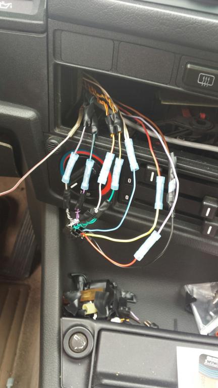

          #64
          88 325is premium sound
          This is where I am at currently with the info I have found off here.
          I deleted out the fader and ran the speaker wires to the harness and left the negatives unhooked still twisted. I have sound coming from all the speakers and the volume is fine but the quality is pretty bad no bass at all it sounds like the speakers are blown when bass hits almost but they worked perfectly fine just before I took it out.
          What do i do from here did I do something wrong?
          I only had 1 blue & white cable on the stereo harness so i had to put both white wires (amp & antenna) together on the blue & white. Is that my problem? Antenna drawing power from amp? or is it this common ground thing screwing with the speakers?
          Any help would be much appreciated. Thanks

            #65
            At that point, you may as well bypass the stock amp

              #66
              gave in and just did it today haha so much nicer!!
