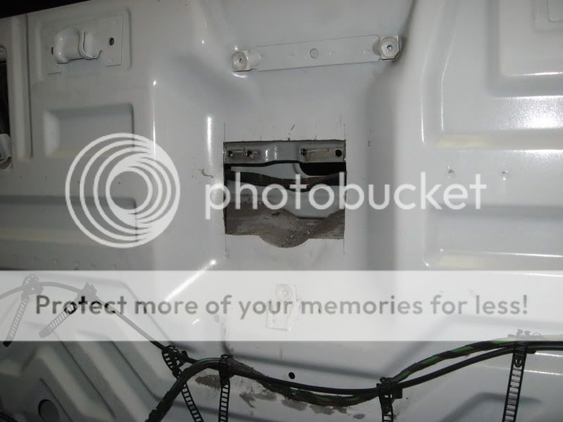

    This is not going to be fun, and I am going to hate hacking into the 2 rear walls to "port" this thing into the cabin... but you do what you gotta do. This is a weekend cruiser and not a track car so I'm not concerned. I NEED good sounding audio in my vehicles so it's a no brainer for me.
    Going to cut 2 5"square holes in the two rear walls and seal the front of the box to the wall of the trunk using closed cell foam. Am also going to use that tar based roofing stuff to seal the holes in the rear wall so that the sub stays sealed to the inside of the cabin.
    I've got the box built and it fits like a glove. Just have to build the flange and gasket on the front of it to seal it to the wall. So far this is what I have done until some equipment starts rolling in.

        Found a place that has the RE Audio available in dual 4 ohm coils.

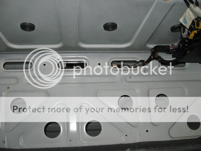

        Also did some cutting to allow bass into the cabin. Am going to use a 2.5" or 3" port tube through the rear seat to allow bass in. I think I am going to delete the rear defroster as mine is non op anyway. The unit itself is good, changed relay, but still no go. But that's another thread...
        Had to make a small notch so that the box wouldn't hit the motor wires coming out of the back compartment.
        "Tucked" the wires into the compartment between the sheetmetal to allow the box to go all the way back. I think I am going to have to wrap them in foam or something to keep them from slapping on the sheetmetal with the bass.
