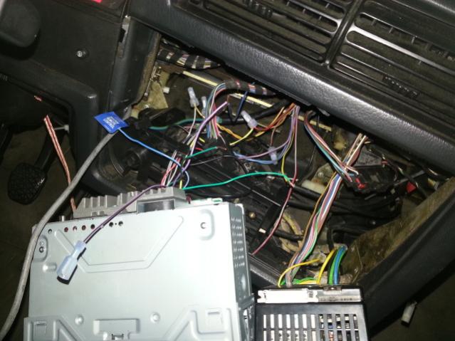

I just installed a Pioneer DEH-X6600BT in my 91 325i with premium sounds following Luke's instruction on the first page. It sounds amazing now. Those factory premium speakers are pretty great I must say.
I did run into trouble trying to figure out the grounding scheme used. I trolled the net but did not find anything that was similar to What I had.
Here's what I had.
Head Unit chassis had two brown wires ground to it through a ring terminal.
Each of this brown wires was wired into 2 Yellow/Brown and 2 Blue Brown wires. These splices were six inches past the fader connector.
At the Amp end. The four wires (2 Yellow/brown, 2 Blue Brown) terminated into a single black brown wire at the connector. I had to strip back six inches from the connector to find the splice.
These four wires were each a part of a twisted pair with a '+' wire as described in the first post.
Once I figured this out, the rest was easy and matched with Luke's main post.
Do it guys, its not that hard after all.
Thanks a Ton Luke. You rock!
