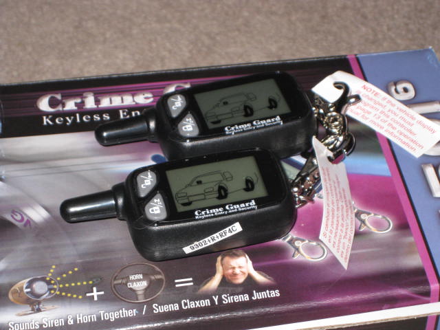

              Check this out. Just got 'em today. Ordered on ebay. I'll take pictures of the install. First time. Alarm virgin. Wish me luck. Any tips?
              • Ziggens96
                • Aug 2005
                • 340
                No idea man. But I imagine there are at least a few aftermarket alarm install threads on here. Sorry I can't really be much help, I like the picture of the guy on the box covering his ears though.
