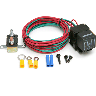

            I'd just pick up a relay kit if it were me. Painless makes a bunch, they have relays with mounting tabs, sockets (weatherproof even), and pigtails.
            You don't HAVE to, but yes I'd fuse all pos. wires. EDIT: just re-read your question- I would fuse the pos. feed TO the relay, and pos. wires coming out of the relay (like your diagram shows).
            As for a distribution point, you could protect outgoing pos. wires with an auto reset breaker. Many have mounting tabs as well and they make great distribution points because they have long studs that can accommodate multiple connections.
            Here's a pic of a 30A Painless fan relay kit that includes a breaker.
