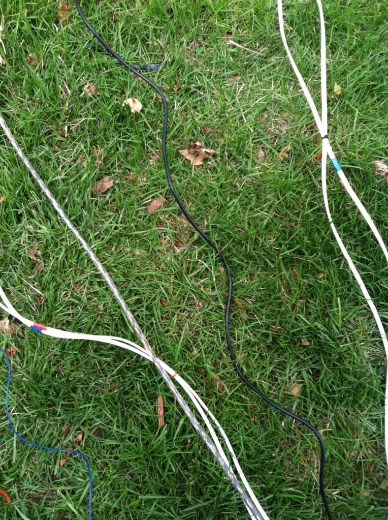

    The previous owner had an aftermarket JVC head-unit install. Whoever installed the unit sliced the factory harness out. They also had the front and rear speakers running off the front channel of the factory amp (rear channel must not work).
    So I decided to run all new wires for everything. So I ran front and rear, right and left lines from the new harness to the stock speaker locations. While I was at it I also ran new lines for when I put an amp on the front speakers. I ran three sets of RCA’s from the HU to the rear as well as a remote line.

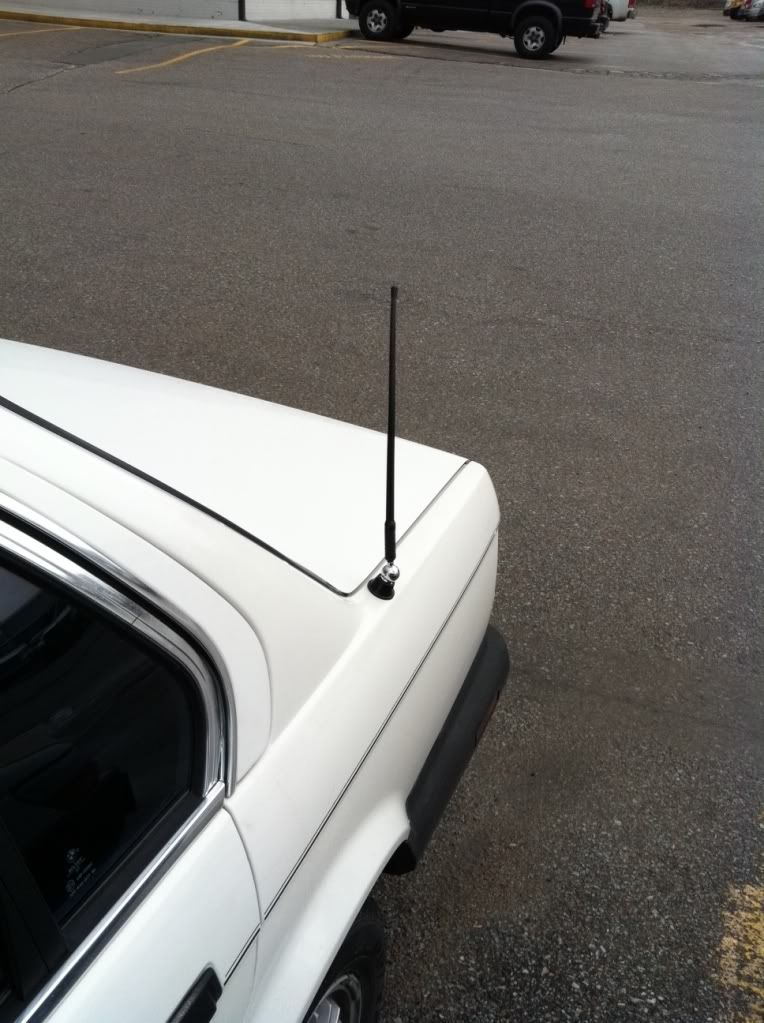

    The previous owner had the power antenna removed (I assume he was going to replace it). Well I am too cheap to buy a factory power antenna, so I bought a new stationary antenna (not pretty, but it will work). I could not find a connector to use the factory antenna wire; so I ran a new antenna wire.
    Wires getting bundled and color coded:

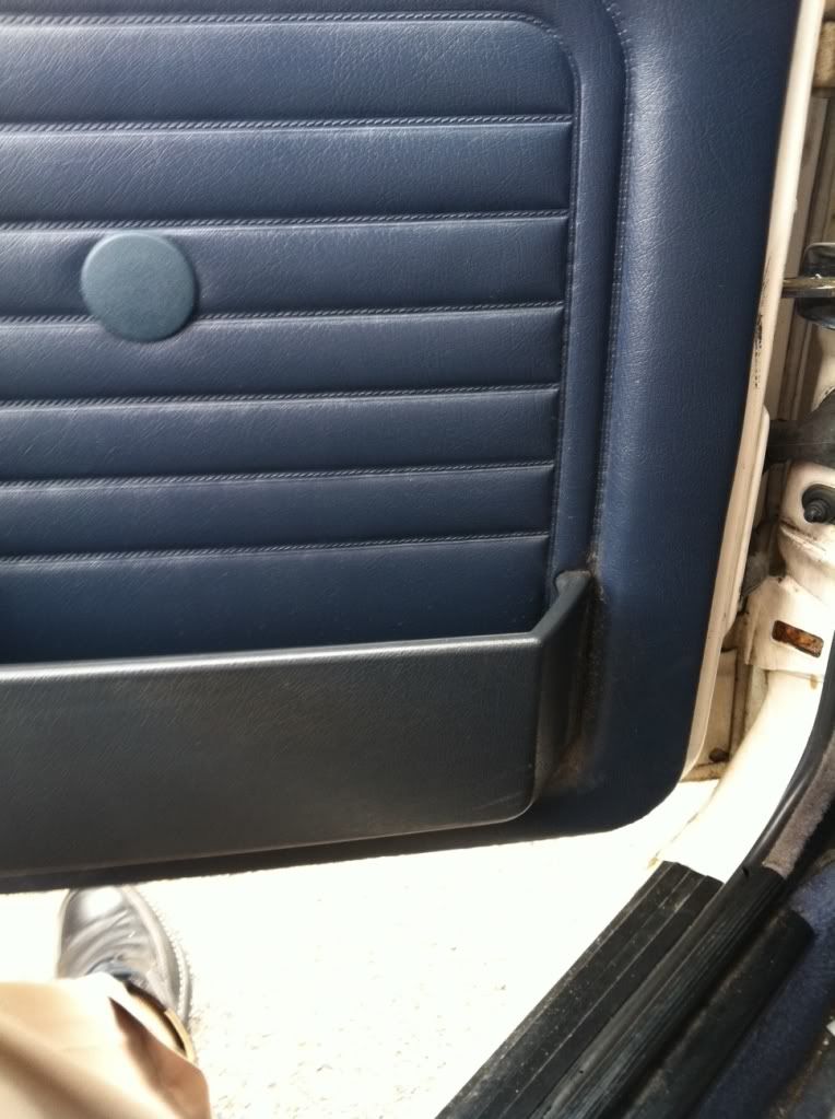

      I am thinking about building door pod for my mid bass. I really don't like the location.
      I am thinking about building some pods here.

        Good lord, man, that antenna is hideous.
        Progress is nice though, huh? How about some full car pics?
          The antenna is only temporary till I find a way to mount a different one.

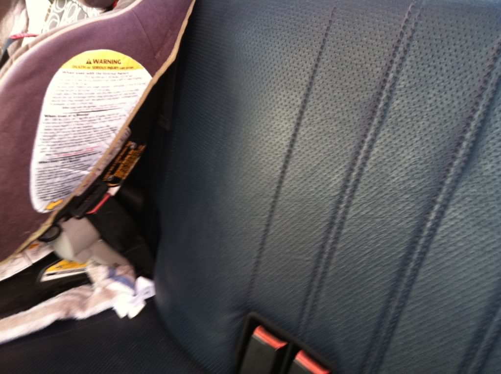

                  I am thinking about ED's now. I know how to build a box I am wanting to try a IB... I have never had a car I won't care if I hack it all up. Your box won't work for me. I have a sedan; no pass through.

                          ALL E30s except very early cars have the ski pass hole, this has been discussed to death.
                          If it has a rear battery provision in the rear (even if battery is up front) it has the ski pass hole.
                          Except tourings and Cabbys, they can both go to hell anyway.
                          WRONG! 87 325e does NOT HAVE ONE.

                          • DRTSRFR
                            • May 2008
                            • 1836
                            Heh...
                            Pop that seat back off and you'll find a ski pass panel.

                              • Feb 2007
                              • 7305
                              You just don't have a backseat with an armrest but the hole is there ;)
