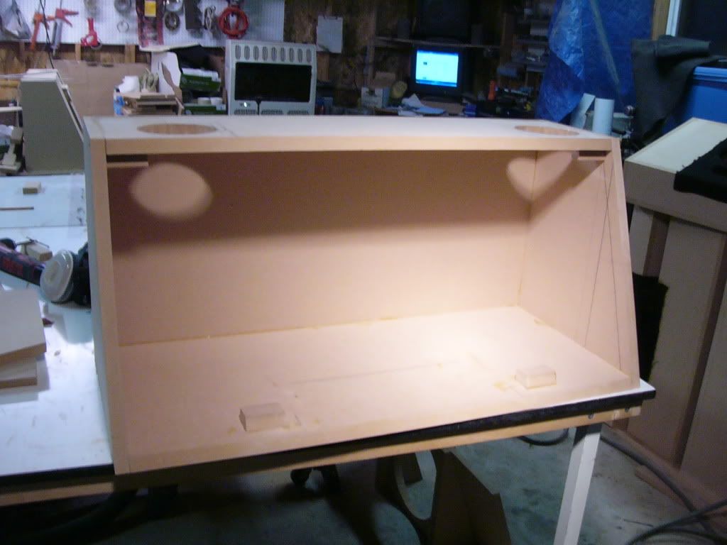

    I have not made another "vertical woofer" box since mine. The reason is that the woofer is so deep, the angle would have it placed above the ski pass hole.
    So here is the bare box:

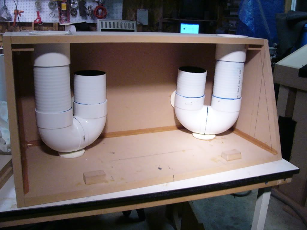

    Ports in place, sealant applied:

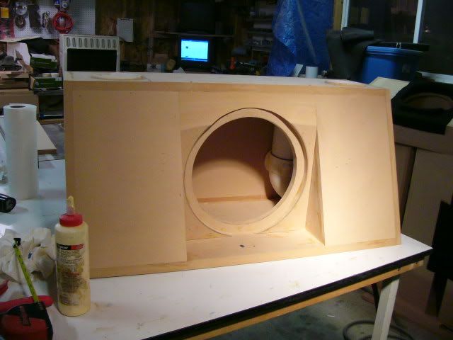

    Face on. There are 2 big front-to-back braces, they are inbetween the U on the port tubes.
    Find Darren at Bimmerfest, take a listen. It will be MUCH prettier than this finished!

              What are you tuning this to?
              • drumad
                • Aug 2009
                • 1700
                idmax, ? and what he said^?
                2008 335i - n54b30
                1991 318i - m52b28
                1994 fzj80 - LAND CRUSHER
                • darrenforeal
                  • 219
                  it's an IDMAX 12 that will be powered by a Arc Audio KS 1000.1. I think he tuned it to somewhere around 26 or 28hz. I don't remember.
