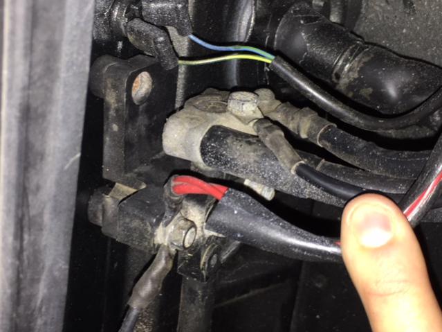

          also can some one tell me if this is the correct way to wire the battery junction. it seems as though every e30 on the internet is wired differently
          87' 325e
