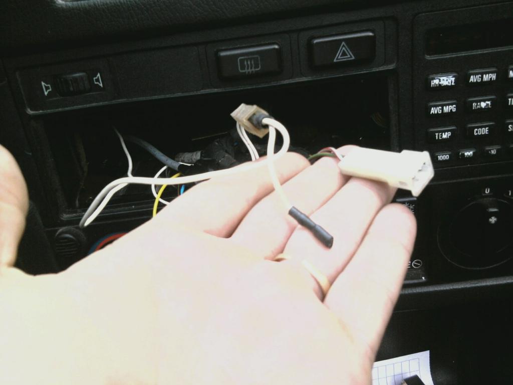

    I have no lights for my control panel or for my left dide of my lower dash ie head light switch or fog light switch. I pulled my radio out to see if there was any thing missing or bulbs to replace but I found 2 connector snot hooked to any thing I believe the double connector may be for the oem radio but have no idea what the sigle white wire is for. Could this be my problem are there any ideas where this would go or what my problem could be please help.

      The heater and air conditionor control s below the radio no longer light.

        Check fuse 23. I literally had the exact same problem.
