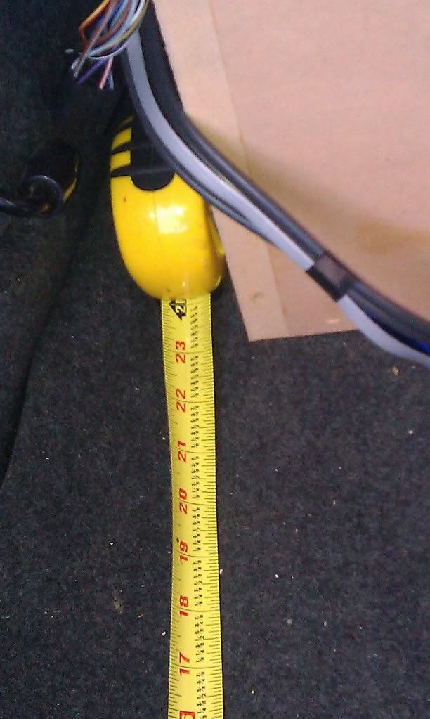

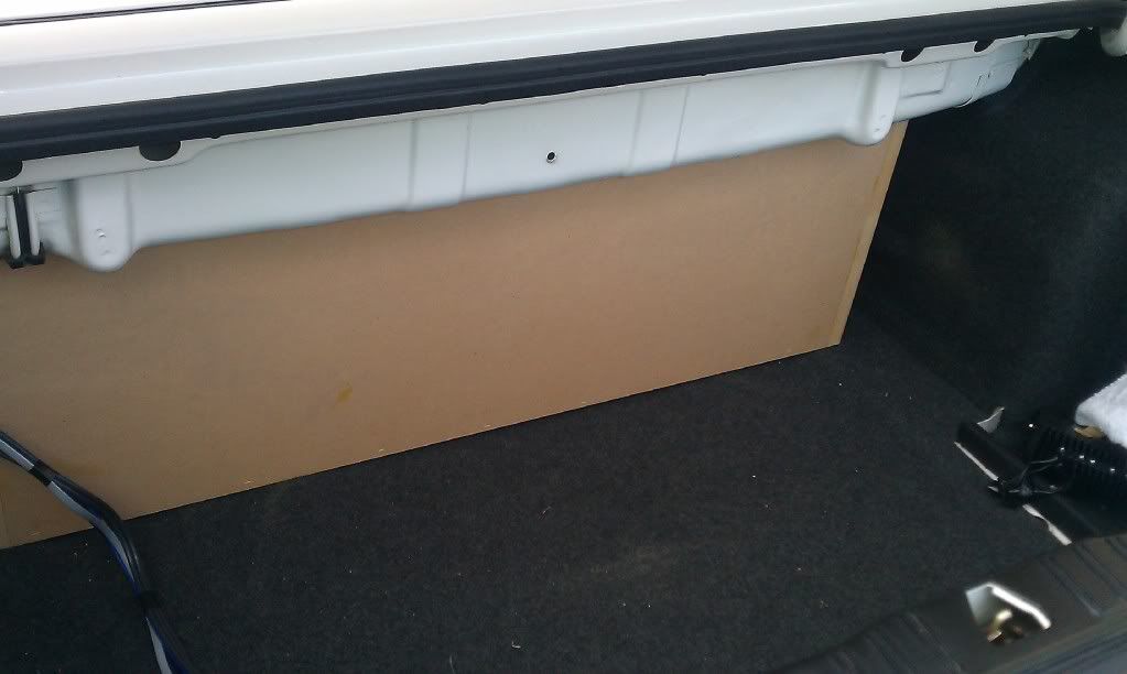

              You MUST cut the wall of your trunk. Don't even think about, here is why:
              The outlined triangles are what needs to be cut out. I say track down someone with a plasma cutter, that is what I will do with this one. I will listen to it first.
              Here is where the woofers overlap the holes. As you can see, this is pathetic, terrible blockage...but the best we can do right now. Shitty compromise, but this needs to get done.

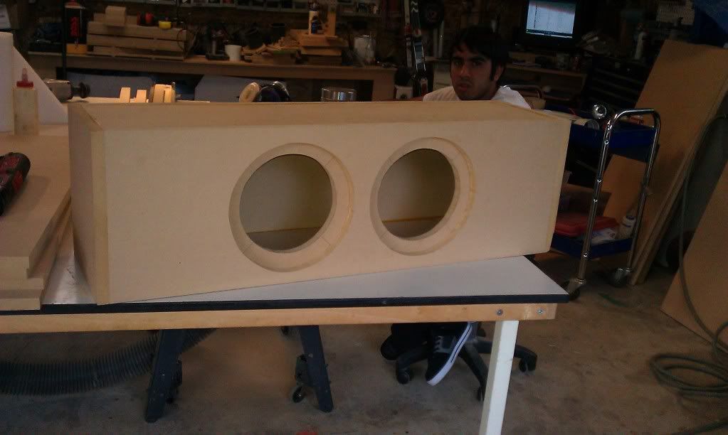

              Here is the face of the box, obviously unupholstered (this is not even glued in yet BTW) and no gasket:

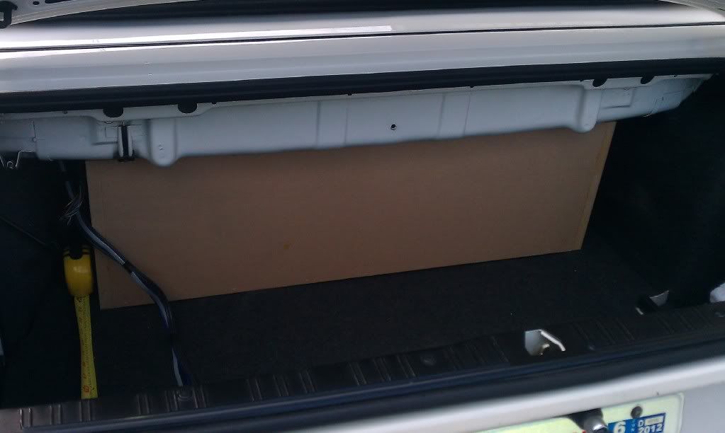

              So, as far as the box itself, turns out we really NEED 1.5 cubic feet on the sealed side. The chamber is 1.35 cubic feet, we will tune that with 2 4" ports, pics shortly.
              What this means is that the box comes nearly to the edge of the top storage area:
              More to come soon. I am only building a total of 5 of these right now, and 1 is going to be in this car. I am thinking we will be looking at finish options, whether or not you want fully upholstered, the optional amp rack, etc. This can dress up VERY nicely, I have a couple of ideas...
              As far as performance goes, on computer this thing should do a solid 135db, or close to it. In car...well, lets hope. The numbers are excellent so far, but the proof is in the hearing.
