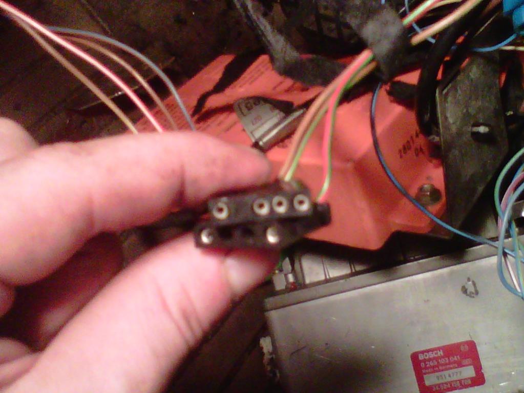

                where do these plugs go?!!!Click image for larger version

                  looks like the plugs for the chime.
                      he's right^^

                        Originally posted by E30_fiend View Post
                        he's right^^

                        also, yes those are just for the chime.
