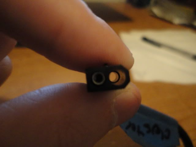

    After taking the cluster and the lower dash panel to change the odo gears, I'm having trouble locating where I can plug in a certain wire. I want to say it goes back to the cluster, but there's no place to plug it into. It's a blue and green wire. On the adapter or plug at the end, it says "AMP 926569" on one side, on the other side it says "BMW 1369229"

    Your cruise control doesn't work anymore does it? That wire looks like the cruise control connection to the green (snap-in) connector on the back of the speedometer - on the back of the cluster. You can use any of the three male connections on the green connector for that wire.
      ^ like he said re: the wire plugging into the green jack.

        I actually haven't driven the car around since I took the cluster out so I couldn't tell you if I'm lacking cruise control, not to mention I've never used it, thanks a lot though! I'll hook it up when I fix my other problem.
