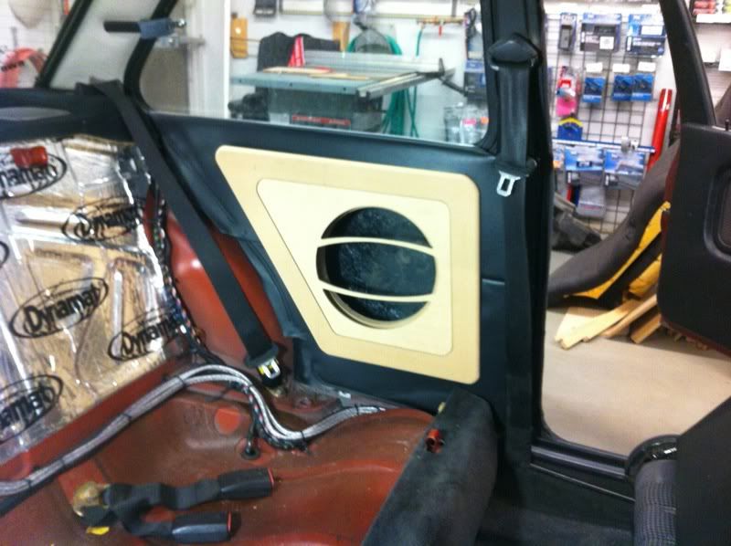

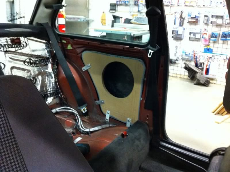

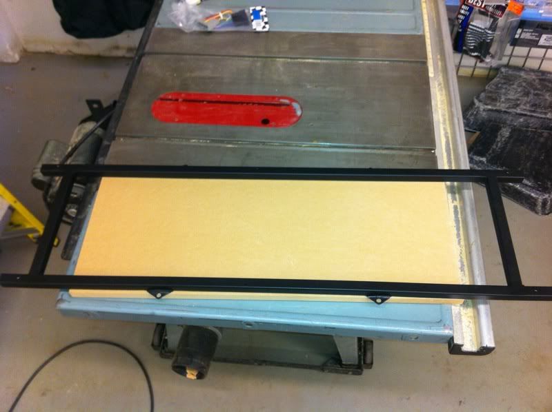

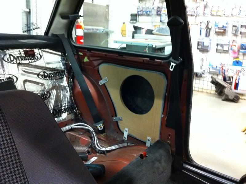

I have mounted the baffles for the sub box. Just need to pick up some aluminium for the mounting tabs, then I can mount the sub and have some bass till I get the trim panels made. It is starting to slow down a bit at work so I should be able to make some progress, hopefully before it gets too warm. Once the weather is nice I will probably abandon all projects except for my 65 Beetle till it's on the road.

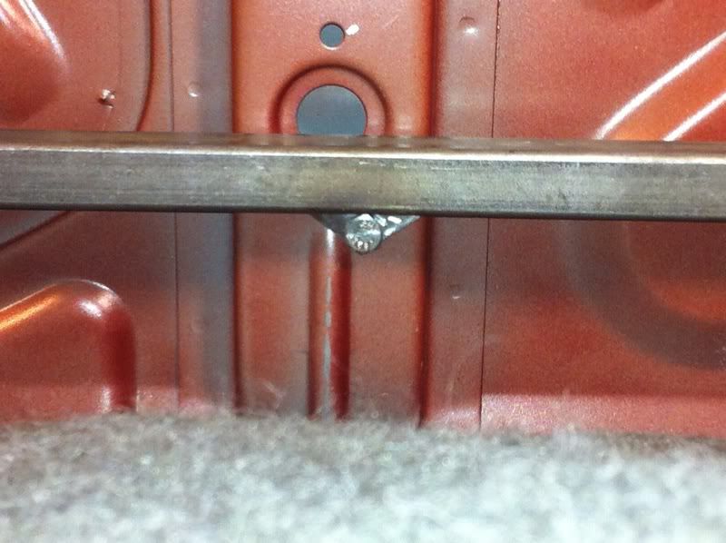

I added another aluminum mounting tab to the top of the enclosure as well, close to the front of the box. I will get a pic of that when I disassemble it all for paint.

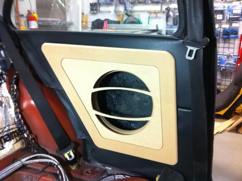

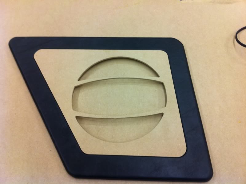

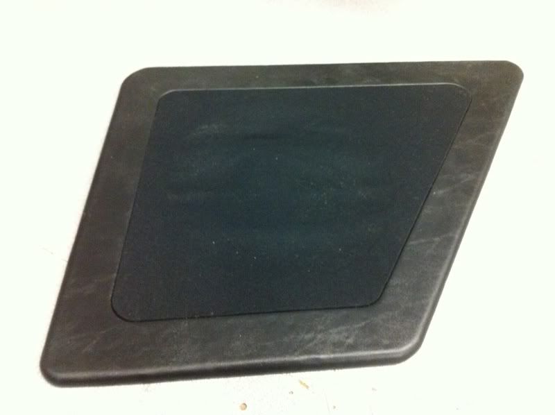

The Trim, will be upholstered in matching vinyl, and the grille insert will get houndstooth if I can find matching material. You won't see the little design I made in the grille insert, it's just there to keep peoples elbows away.

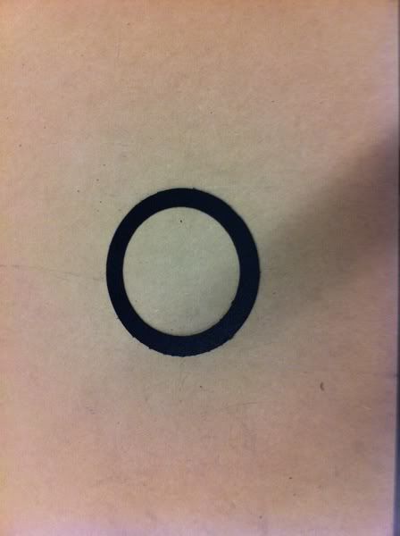

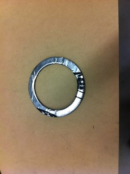

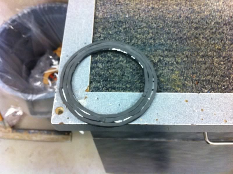

I also realized since I told everyone else to seal the gap a 5 1/4 leaves in the front kickpanel, I should do it too.

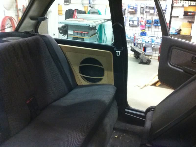

Once the sub boxes are done, I am going to modify the kickpanels, so the speaker has more room between it and the plastic, and to get a grille with more open area in front, that should really help the SQ.
