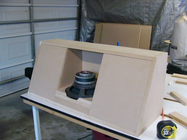

      If you want something insane, I am able to do "one off" customs. We also offer the "beast box" which could potentially fit a JBL GTi 10. That woofer is dual 6 ohm, so you could run your PPI on a 3 ohm load...just make sure it has a fan on it and SOLID current available.
      If I were you, I would look for a dual 2 ohm, but most are too big to fit the depth.
      Here is the issue with depth: as you can see from all the pictures of the 10'' box installed, the port tubes are as close to the woofer as possible. The port tubes are as high as possible in the box, so you really can't raise the woofer at all.
      This car has had the area around the ski pass upholstered so it looks nicer with the armrest seat in, but you can see clearly that the ports are at the absolute top edge of the hole:
      If you were to see the clearance of the magnet structure to the floor of the box, you would see the issue is more a matter of "woofer height" than it is actual depth. I can get a bigger woofer in by building the box deeper (obviously, it would be bigger than 1.5 cubic feet at that point), but you can't get anything like an HCCA10 or the JBL at all in an E30 when the woofer is on the face of the box.
      This is why we developed the beast box.
      This is an early prototype. This particular shot has the parts of the box literally just sitting in place. The ports are installed on either side of the woofer. We are trying to work out a way to get dual 4" ports...those woofers (not this POS test mule) move a TON of air:
      The final version will have a plexi window, LED illumination and an integrated amp rack, but designed specifically for the Soundstream "Stealth" series amps, or other similar small amps (PDX, etc.)
