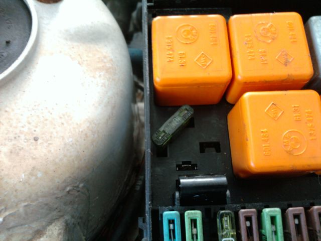

            Ok new info!
            No power at window breaker. No power at any switches.
            NO POWER AT FUSE!?!?
            What does that mean! No power to the fuse? So there is a short before the fuse box?

              Probably not a short. If it's a wiring issue it's likely a cut or broken wire. But more commonly the female receiver that that fuse goes into has receded down too far into the fuse box, not making contact.
              Are you sure the multimeter probe is hitting it?

                i stuck the prongs all the way down, definately had contact with the connectors for the fuse.
                  Pull K5 and move K7 where K5 was. Might be a bad or incorrect relay.

                    Pulle the relays and switched them around, still NOtHiNG!!!
                      Thats shitty!
                      Hmm. Do your gauges and other crap on fuse 10 work?

                        yeah, the only thing not working is the speedo since the speed sensor wire was cut at the diff somehow.
                        if i can't fix it soon(read as its getting fucking hot) im gonna just take it to a local shop, which i absoultely HATE the idea of, but sometimes you have to admit when you are out of your element, i am a parts installer, not i diag specialist lol
                          Give this a try and see if you at least get power to the fuse.
