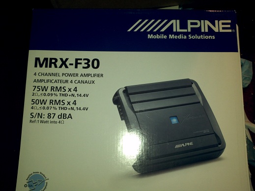

                        to power the pioneer speakers i have. i got this:
                        Much wow
                        I hate 4 doors
