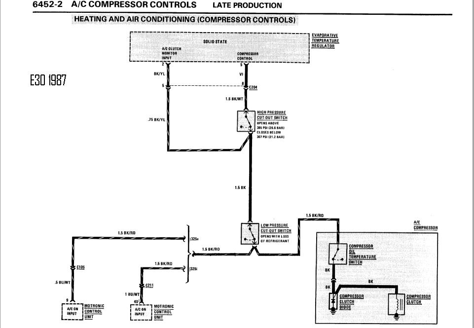

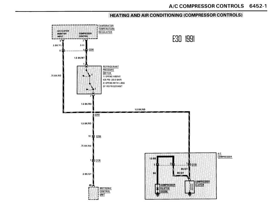

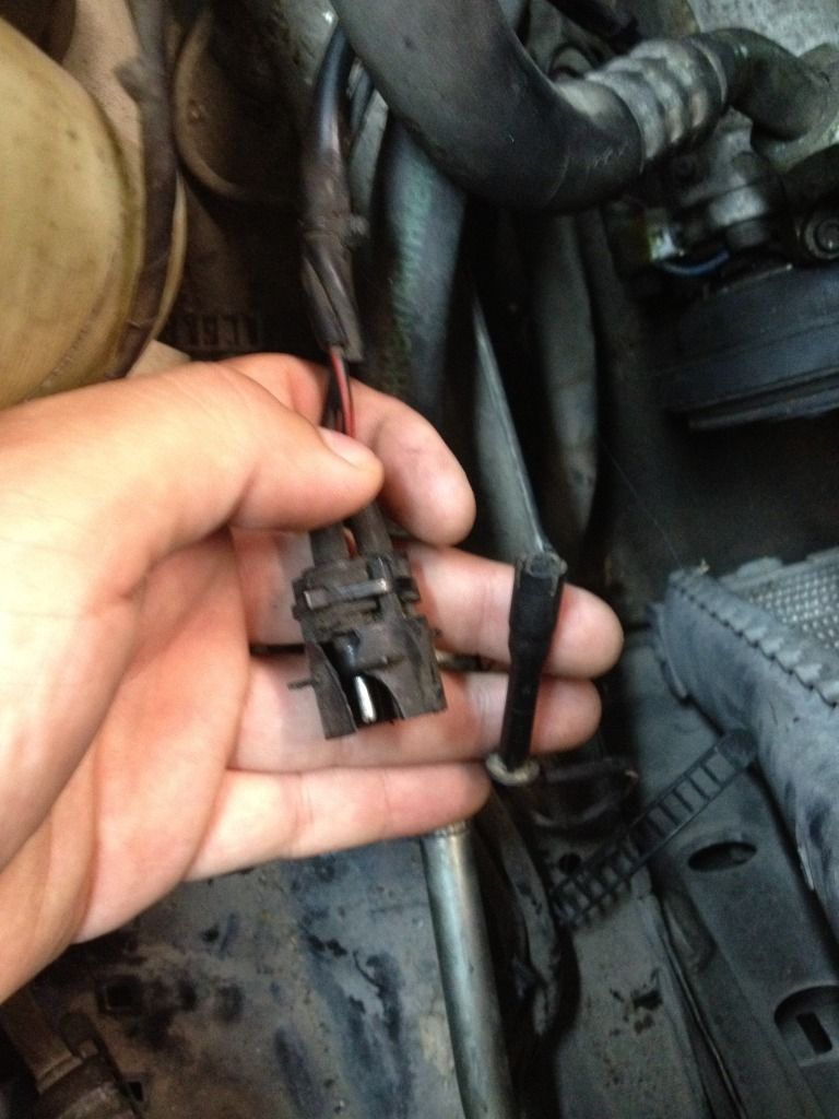

Anyway. I have an issue with the late model engine into the early model chassis. The compressor has it's own 3 cable plug which contains 2 black/red cables and a black cable assuming that's the ground. The early model chassis only has one black/red cable and that's it. Which one do I connect it to or do I connect both to it? Essentially, Why does the late model have two cables and the ground? What kind of signals are being sent from each cable that the early model only required one?
I'm having trouble deciphering these diagrams.
They both have two Black/red cables coming from the switches. One having the extra low cut pressure switch and the other showing the 325e motronic unit, but other than that, They show that both should have two cables. I'm confused.
