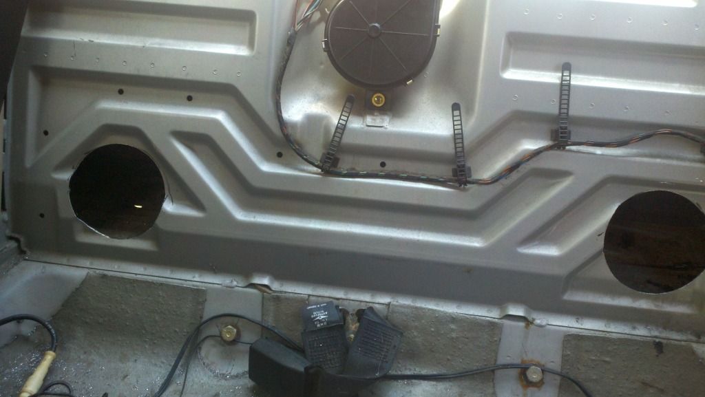

          Alright, so here's a few photos of the setup. I did manage to take one picture during the process, but it isn't too exciting:
          You can see through the hole I cut on the left side of the photo some light coming in through a drain hole. There's another just inside the right hand hole as well. It didn't look like any water had ever been in the chamber of horror (an apt description given by Luke), but I left these uncovered anyway when I did the butyl rubbber sound deadening material.

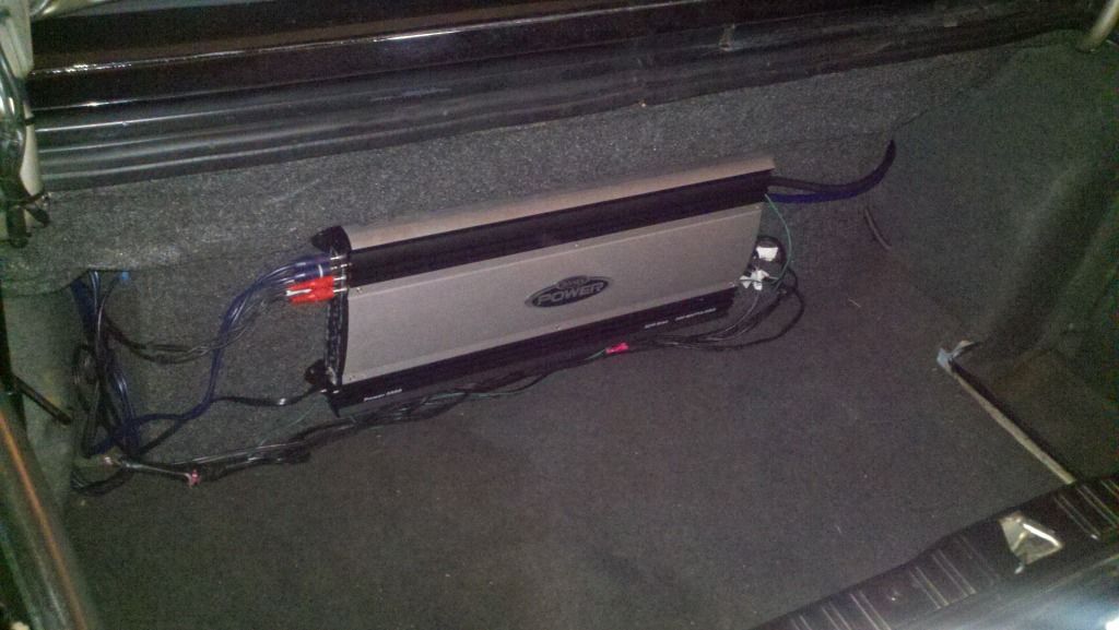

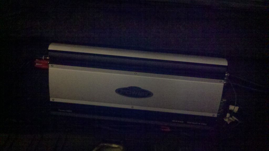

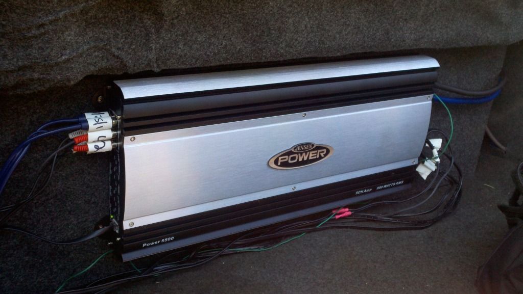

          Fast forward to completely installed. Here's an exciting few pictures of the amp. I still need to do some cable tidying.

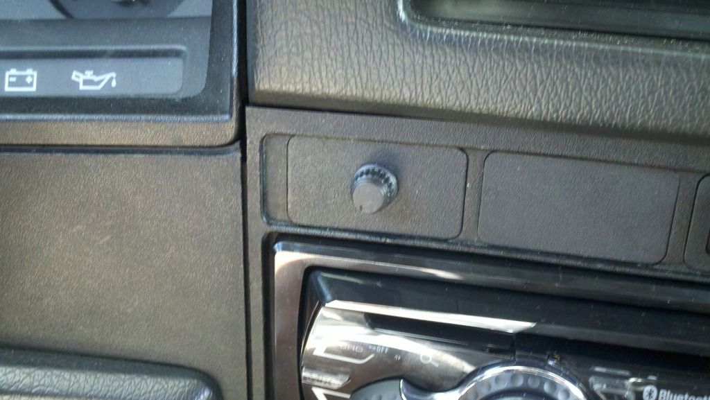

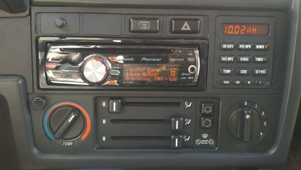

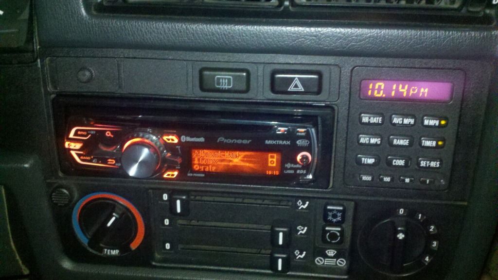

          Head unit installed. You can see the knob for the subwoofer lever to the upper left.

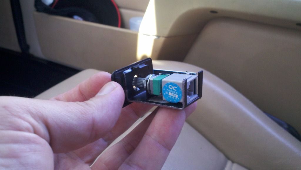

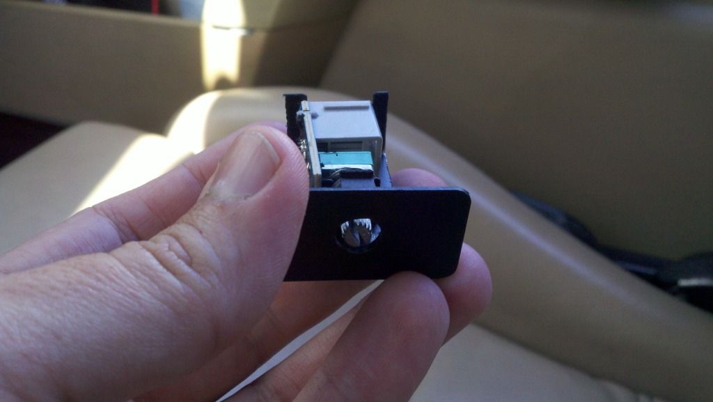

          For the subwoofer level control I took a blank panel filler, drilled out the center for the knob, and then disassembled the subwoofer control & cut the case down so I could epoxy it to the back of the panel filler while still holding the knob mechanism securely.
          The color on the Pioneer matches the dash & OBC illumination pretty closely. It can be set up with a custom color, but I haven't dug into that yet. My only complaint at this point is the display on the Pioneer is hard to see during the day, in the color that matches the dash lights. If I change it to white, it is pretty easy to see.
