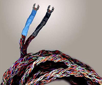

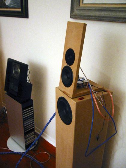

                          maybe i should have explained further on my previos post. i use cat5e which is made of 6 pairs of wires, combine the + and - of those 6 pairs gives a big enough gauge to carry power to an individual tweeter or lower power demanding woofer. by running a cable (6+ and 6- 24 ga. wires) to each speaker should give me a large enough gauge to carry the current needed.
                          search some on the internet and you will find that the sound quality from cat5, used as speaker wire, compares to some of the very high hi-fi speaker wires out there such as Kimber, Audio Quest, and XLO which are on a level above Monster Cable which i used to use. the individually insulated and spiral wound (of + and -) strands of wire keep out a lot of exernal "noise" that causes the distortion and static heard from speakers. inside a car with hundreds of wires and many electrical componets in such a small area, the way cat5 is made would help to block out much of these electronic noises emitted so you dont hear it in your music.
                          although im not saying that a car is the ideal place for hi-fi sound, the amount of clarity and detail that comes out of the treble and midrange using cat5 is quite considerable (atleast from my personal experiences with my hand-made home audio setup using Vifa drivers as well as others that have posted similar findings on the internet).
                          here is a close up pic of some cat5 speaker wire and a pic of one of my speaker towers when they were being tested and tweeked
