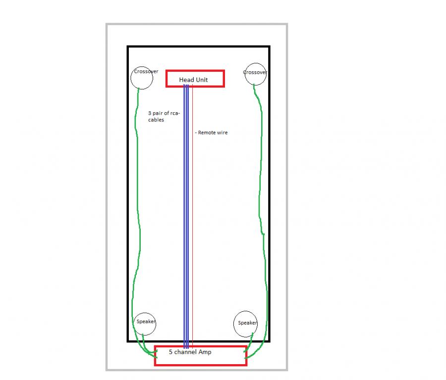

                          Okay I'm about to pull my carpet and most of the interior out of my car. What wires should I be running while I have wide open space.
                          Three sets of RCA cables from the head unit to the 5 channel amp.
                          Remote wire from head unit to amp.
                          Speaker wires from the amp to front crossovers
                          Speaker wire from amp to rear speakers(Coaxial or crossovers)
                          If im correct the only thing that i will need connected to the head unit is the remote wire and RCAs. And all of my currrent speaker wire can be capped off and tucked away. Is this correct?
                          And this poor drawing because im a visual learner.

                            Oh hell no, use the stock wire!
                            its all covered in the bypass thread, the stock wire kicks the shit out of aftermarket wire...even 20 years old!

                              The only way for me to get stock wire is go to the junkyard and pull it(which i was planning on doing). I have a non premium system and Ive noticed that my wires go from the head unit straight to the speakers. Or I suppose I could clip the stock wiring at the head unit cap them off and reverse the roles of the wiring.
                              Such as clip the front wires. Might give me 5 foot of wire, and use this from the rear speakers to the amp
                              Clip the rear speaker wires maybe give me 15 foot of wire. and run this wire from the amp to the front crossover.
                              This would be a pain in the ass for a later owner if I were to decide selling the car.
