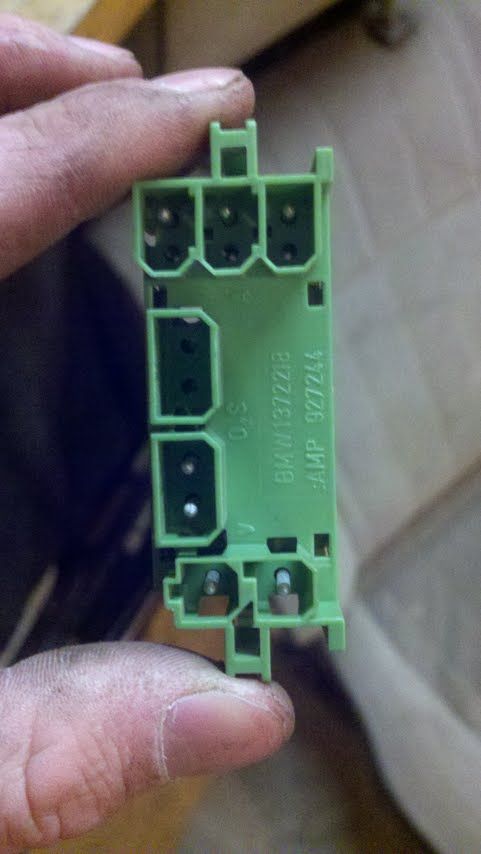

Also, as I found out with my CC after replacing cluster lights, the wire that you reconnected from the back of the cluster is the speed signal coming from the speedo in the gauge cluster going to the CC "brain box". If you didn't plug it in to the right spot it won't work. I want to say it plugs into the bottom right corner of the large connecter area on the back of the instrument cluster, but it's been a while since I did mine and I'm currently deployed so I can't look.

I have once again pulled my dash and i found I had put the blue wire into the wrong spot, but now i am not sure which is the correct one, I am certain it must be one of the 3 spots at the top of the picture touching my index finger. can someone confirm which spot is correct for the little blue wire?

Seems like I read from different sources that any of the three will work.. and I have a memory of looking the plug over and noting circuitry running to all three of the plug-in points.

I fixed it, i went with the top left for anyone who needs this.View my build thread. http://www.r3vlimited.com/board/showthread.php?t=287724
