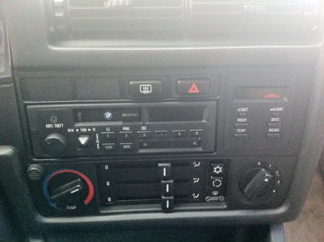

    Will this BMW CD Changer work with this Radio?
    Do you know if this BMW CD Changer will work with this BMW head unit? Thanks much for your thoughts.
    -Marc

    Those decks did not support changers, you need the later style IR deck, or the late late E30 / Early E32 deck
    • bmw325csi
      • May 2007
      • 4045
      I think you need the e36 style deck though. the earlier ones use a round connector to the changer.
