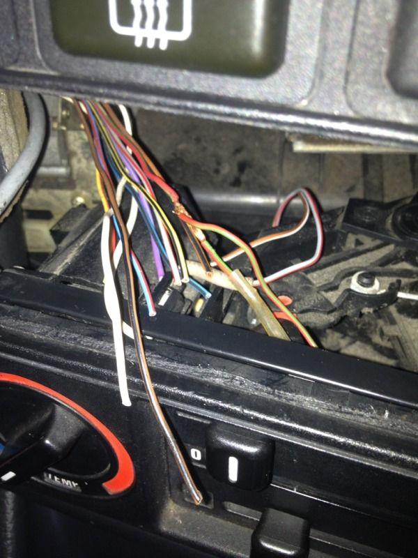

    PO cut the plug for the radio.... :(

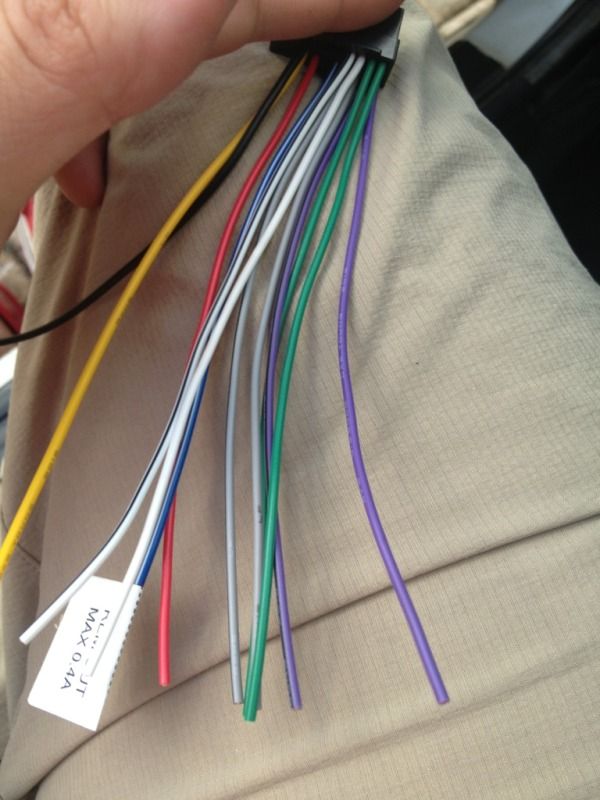

    Now i have a bunch of cables and the plug my sony brought.
    How do i put them together without the oem plug??

      I have these color wires:
      1 White (thicker)
      1 brown/black
      1 white
      1 blue/red
      1 red/green
      1 yellow/red
      1 yellow/black
      1 grey/red
      1 blue/black
      1 brown/black
      1 purple/blue

        Do you have a meter and a 9v battery?
          The purples, Greys, greens, whites are for speakers on the Sony side. The rest should be power, ground, ignition power and antenna. Those are the ones you need to hook up to the car side.
          Brown is always ground. Purple is 12v. You will need a test light to find 12v switched. Not sure on the antenna but I think it orange.

            Got it worked out.
            PO had taken out the fader and factory amp...
            Lol
            Fixed it up and have a radio!!!
