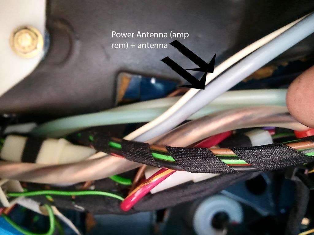

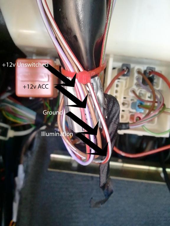

        Dunno if this will help but I recently stripped out my interior to run new wires through my car cause I added an amp and sub and didn't have the premium system previously. I left the 6 important wires though which can all be found behind the glovebox (assuming your's car is similar to mine LHD vs RHD). Are these what you are looking for?

            i did run wires on the left side of car. and i hooked all the positive and negatives to the speaker. but what do i do about a main ground and power?
              also what is the difference between unswitched 12v and acc 12v?
                unswitched 12v is hot all the time no matter if the ignition is on or off. acc 12v is switched, It's only hot when the ignition is on.
                I don't know enough about this stuff to tell you where to get power. Sorry I can't be of more help.
                  i actually figured it out. ran my switched hot to the ignition switch at run and to battery power. now i have a functioning radio!
