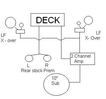

                  Luke, you know i love that you always come threw with the knowledge... I need to pick your brain some more. I'm ready for some audio. I still have that same alpine deck and im thinkin separates up front and a single 10 in the trunk. You mentioned that my deck was capable of tri-amping. teach me.... how many channel amp should i pick up? 2?
                  This is how i have it pictured...
                  Any thoughts? Will i be able to have separate control of the sub volume from my headunit?
                  -Greg

                    Greg, that is the normal setup, AKA 'Bi-Amping". Front, rear and subwoofer, means 1 "electronic" crossover point, that being low pass for the subs and high pass for the mids/tweets, which then run into their "passive" crossovers to send appropriate signals to the mids and tweets.
                    The deal I was describing is called "Tri-Amping" and uses seperate power and 3 "electronic" crossover points for the tweeters, mids, and subwoofers, with no passive crossovers at all.
                    You would then have low pass for the bass, "band pass" (passing midrange only) and high pass on the tweets.
                    Your deck can do it. You would not use rear speakers at all with that. It sounds absolutely amazing, and the stock speakers will just astound you using deck power for the front and a small mono amp for the Knicker.....er.....Kicker sub.
                    Voila.
                    Vee-O-LAH!
                    Luke
