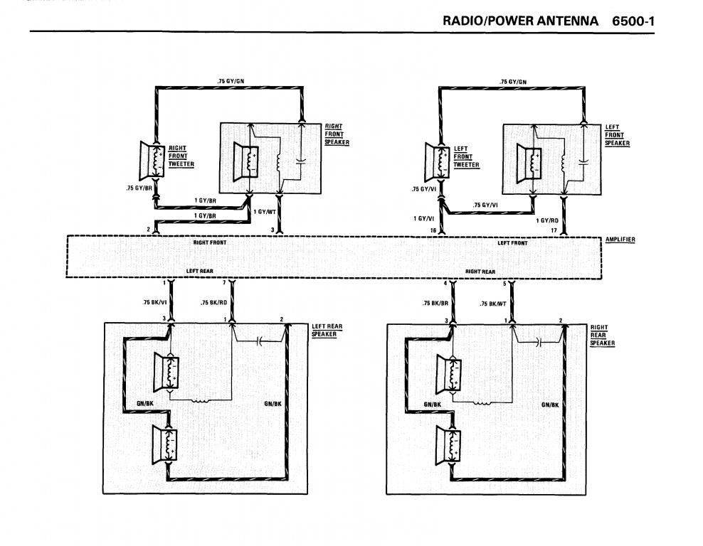

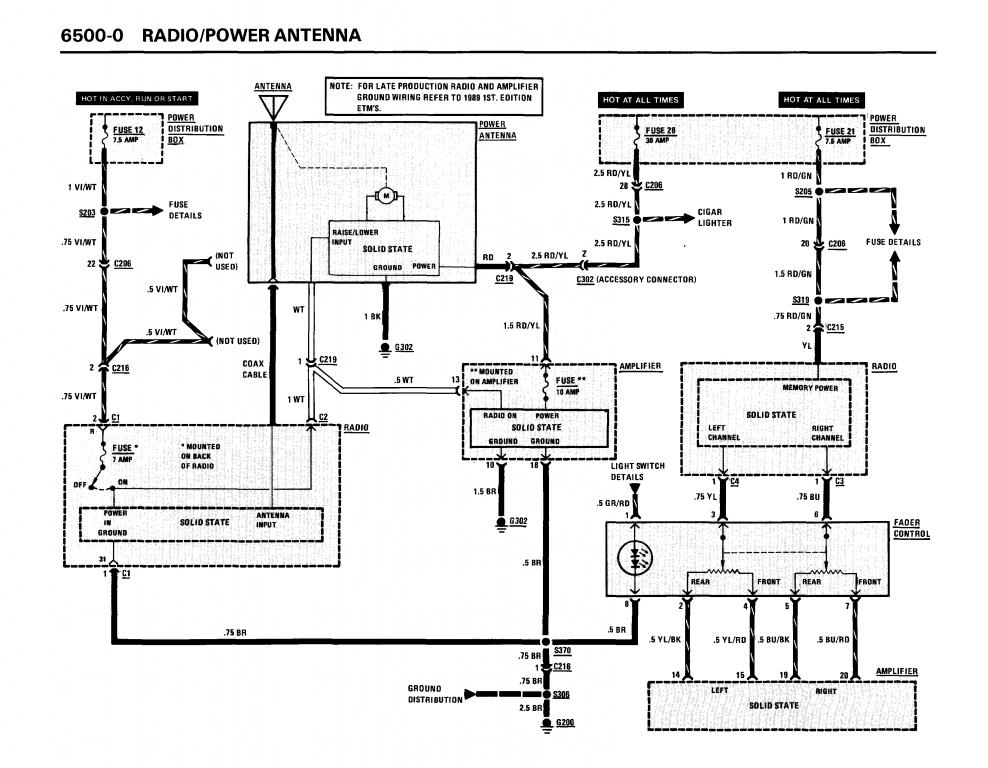

            heres the diagram

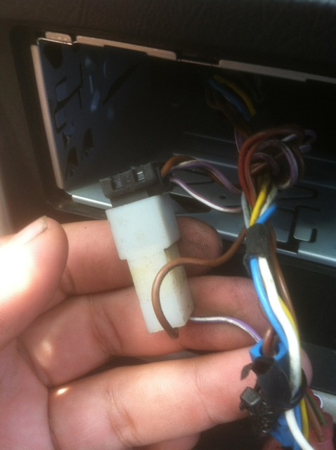

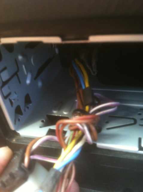

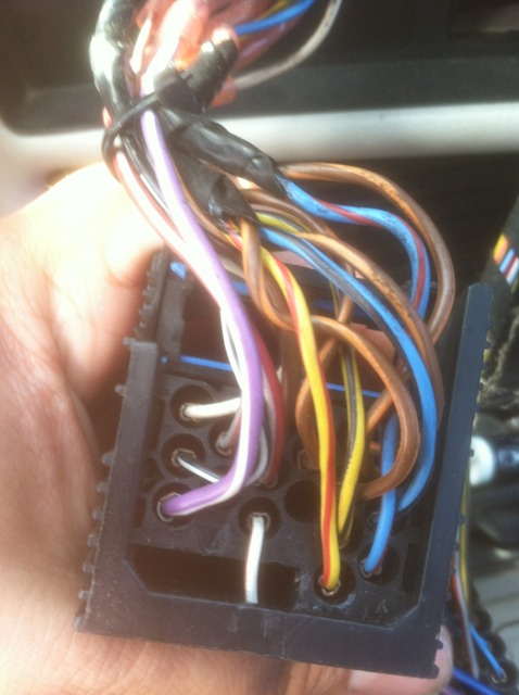

                        Alright here's pics.

                        This is the plug for the adapter
                        Random plug
                        More wires
                            This is the fader
                            [ATTACH]68338[/ATTACH]
                            [ATTACH]68339[/ATTACH]
                            Random plug
                            [ATTACH]68340[/ATTACH]
                            More wires
                            [ATTACH]68341[/ATTACH]
                            Holy crap.
                            Now I see what is going on here!
                            You have a serious oddball, one I have never seen in person.
                            Your car has an adapter that allows use of later BMW radios. It is kinda hacked together, but clearly the intent was to use a later radio.
                            Kind of a shame too, as had the installer taken apart (unwrapped) that stock deck harness and fader harness, they would have found the wires they need.
                            So I gather you now have a couple sets of Infinity speakers and you want to install them. What deck do you have and what year/model is the car?
