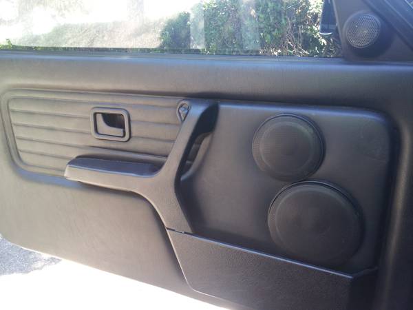

                          Any pics of these installs ?
                          • Cabriolet
                            • 9620
                            I did some big-ass Polk MOMO 6.5's with just a 1/4" MDF spacer under the door skin, they fit great.
                            In for pics, i have yet to see a clean door install.
                            this guy did it to his m3, but it looks so wrong
