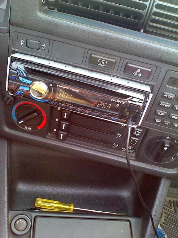

          How about a pic of the carnage? Is there a "sleeve" in place? The Sony requires one, it came with one when new the sleeve or "cage" has tabs that fold out to mount it in the dash, and has tabs that hold the deck in.
          Post a pic, we will help you fix it.

              ^ there is your problem, none of the tabs are bent out.

                Yup, on the sides you can slip "keys" in and pull the deck out of the metal cage. Then put the cage in, bend the tabs so the cage won't fall out, then slide the deck into the cage.

                  The keys will look something like this:
                  Basically just some thin strips of metal. Slide one down each side and it should pull out.

                      Slide your deck out, you will see there is a sleeve of metal around on it, that is the sleeve or "cage".

                        The metal cage is the metal cage around the outside of the plastic in your picture. The deck is everything inside that. Also called a head unit or CD player.

                            I removed the aftermarket radio that came with my car by sliding two butter knives between the head and the cage, one on either side. Worked perfectly.
