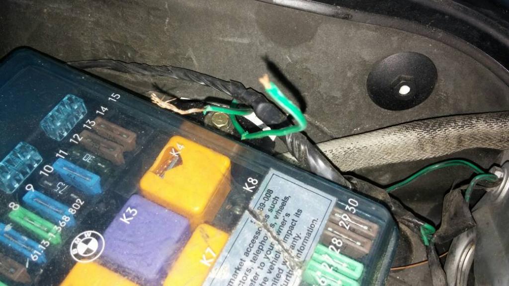

    The P.O. apparently disconnected the horn by the fuse box. How do I wire it back in?
    Any help would be appreciated.
    Thanks!
    DanClick image for larger version
    Sent from my VS980 4G using Tapatalk

    are the connections still in the fuse block? you will need to get new pin connectors and find the corresponding pin holes to reinstall the connectors. if that is what you are referring too?

      Where in the fuse box should the connectors be?

        Why do you think those wires are for the horn? Do you have better pictures?

          The wire from the horn is violet and the wires to the horn are violet/yellow.

            I can get better pics tomorrow. I know those are the horn wires because I traced them back from the horn.

              what color are the wires? They look like green with a gray tracer and green/black.
              You can see there are no green wires related to the horn. Only violet and violet/yellow are related to the horn.
              The above link has the wiring diagrams. More pictures and information are needed.
              If you do need to reconnect to the fuse box, you should read this to get a better understanding of the pins.
              Lets see where you traced the wires from and some other pictures.
