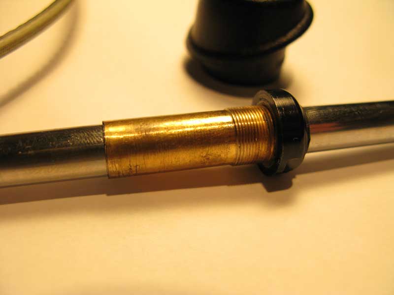

              The car is a 1987, so I'm a little confused. PO is my mama so hopefully no fuckery haha. I have seen early chrome antennas...mine isn't like that. maybe this isn't a stock piece? the top of the antenna mast says " h 10" on it and I've taken it apart before and so I know for a fact it's a Hirchmann unit. anyway, here's the pics for tonight. tomorrow when it's light out I'll show you what it's like with the radio on, how the broken part of the nut can be picked up and slid up and down on the mast.
              See the nut I'm pointing to? The top where you'd grab it with a wrench snapped off the base and spins freely on the antenna, but the base of the nut is still in the hole, retaining the mast in there
              Also, thought it might be worth noting that the grommet is OEM, changed it myself, and no leaks. fits this antenna perfectly.

                It looks like the "nut' has sheared off from the threaded sleeve.
                That assembly comes with a replacement mast.
                The difficult part is removing the threaded sleeve that remains inside the motor assembly.
                Do you need to replace the nut? I believe the threaded sleeve is the part that actually retains the mast.

                  YES! That is what is supposed to look like

                    Oh thank goodness! haha I sweat the small stuff! Well knowing that that's all it is, I guess I could get the threaded part out with some vise grips and swear words right?
