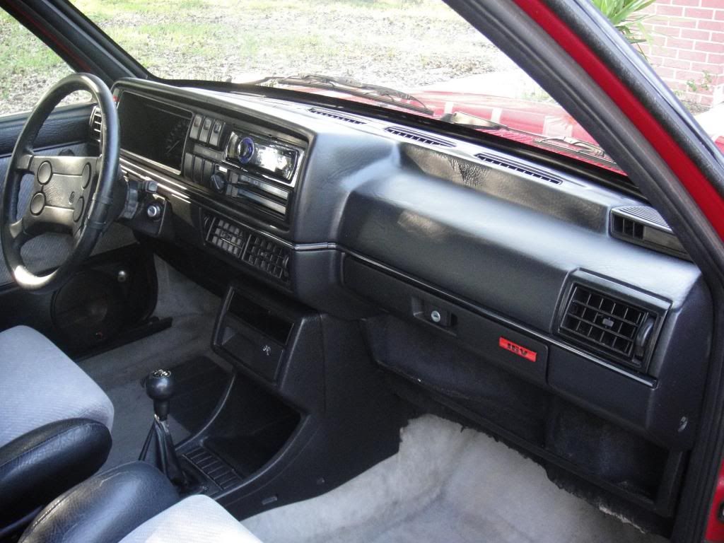

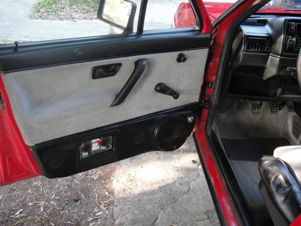

  • Silver Wagon
    replied
    Originally posted by Liquidity
    And tweeters on the dash for soundstaging - ideally pointing up and reflecting off the glass.
    no, put them in the kicks also. the closer you can get equal distance of both tweeters to your right ear, the better. the kick panel is the only place in the car that offers that distance.
    here are some pics of some door panells i made for my Jetta years ago. people would call me a lair when i told them there wasn't any speakers in the dash
    you can just see the tweeter, how it looks with the door closed in this one.
