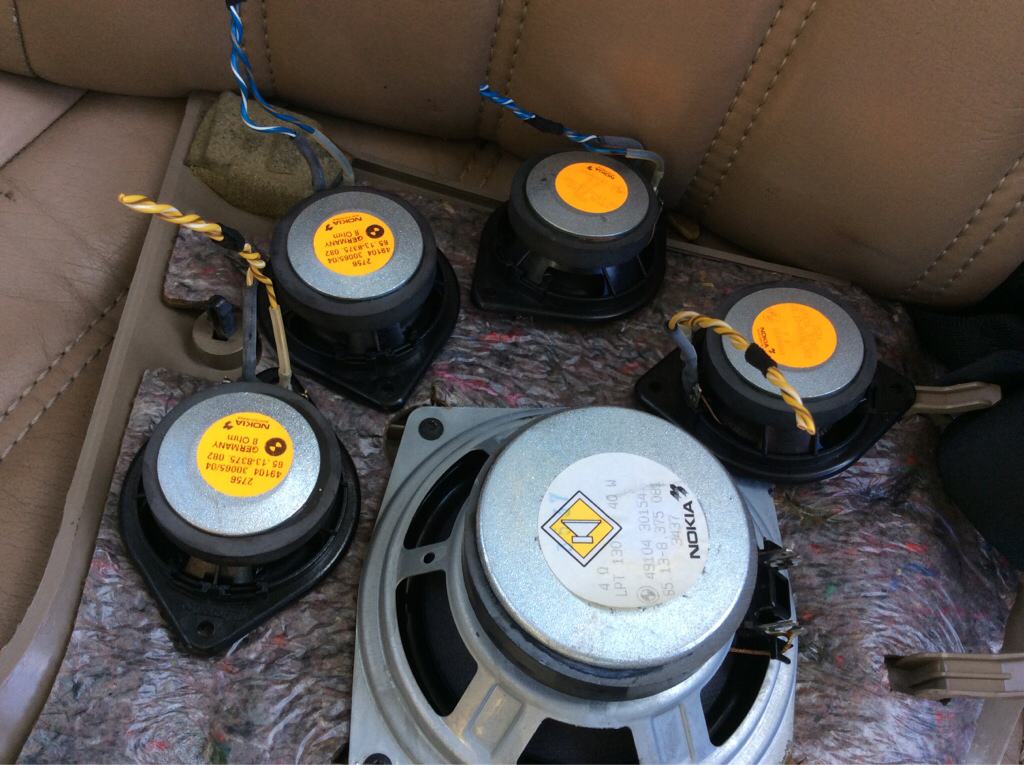

      Haven't cleaned them up yet, or tested, but all seem to be salvageable.

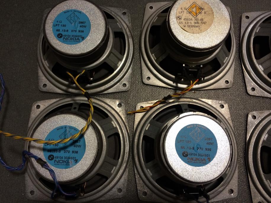

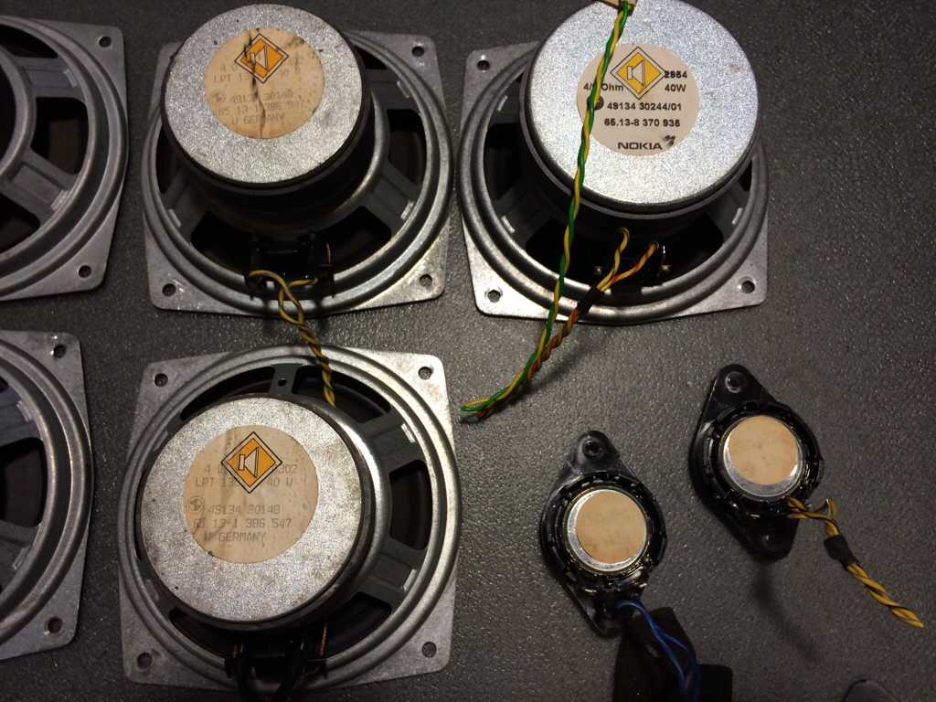

      Three blue sticker 65 13-8 370 963 4ohm 40w
      Three white sticker 65 13-1 386 547 4ohm 40w and one DVC one for telephone or something? 65 13-8 370 935

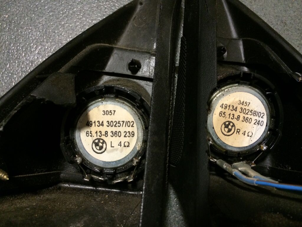

      Two rear tweeter 65 13-8375 085 4ohm, two front tweeters 65 13-8 360 239 "L" 4ohm and 65 13-8 360 240 "R" 4ohm

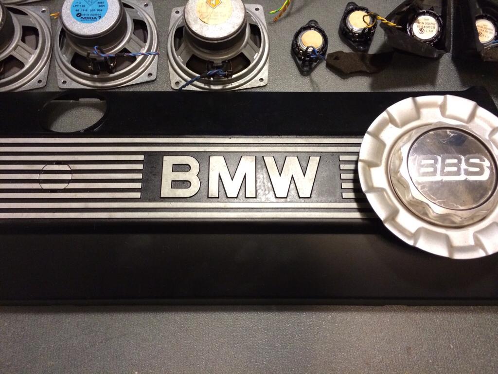

      BBS center cap 09 24 375, engine cover 1738 174 0

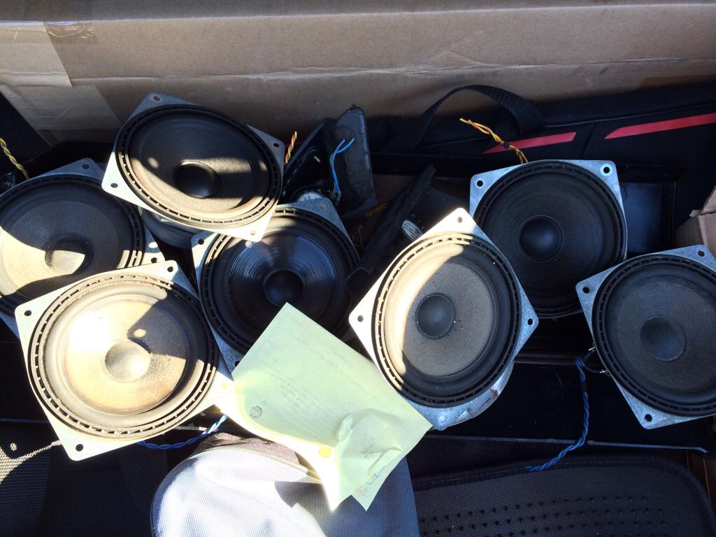

              Ok, went back and got the rest!
              4 mids 65 13-8375 082 8 ohm and one more midbass 65 13-8 375 081 4 ohm. I accidentally tore a rear midbass so left that one :( Anyone ever done a 12-13 speaker setup in an e30? Placement would be hard! Off the shelf 3 way crossovers on parts express are about 800hz-5khz does that seem about right for these speakers?

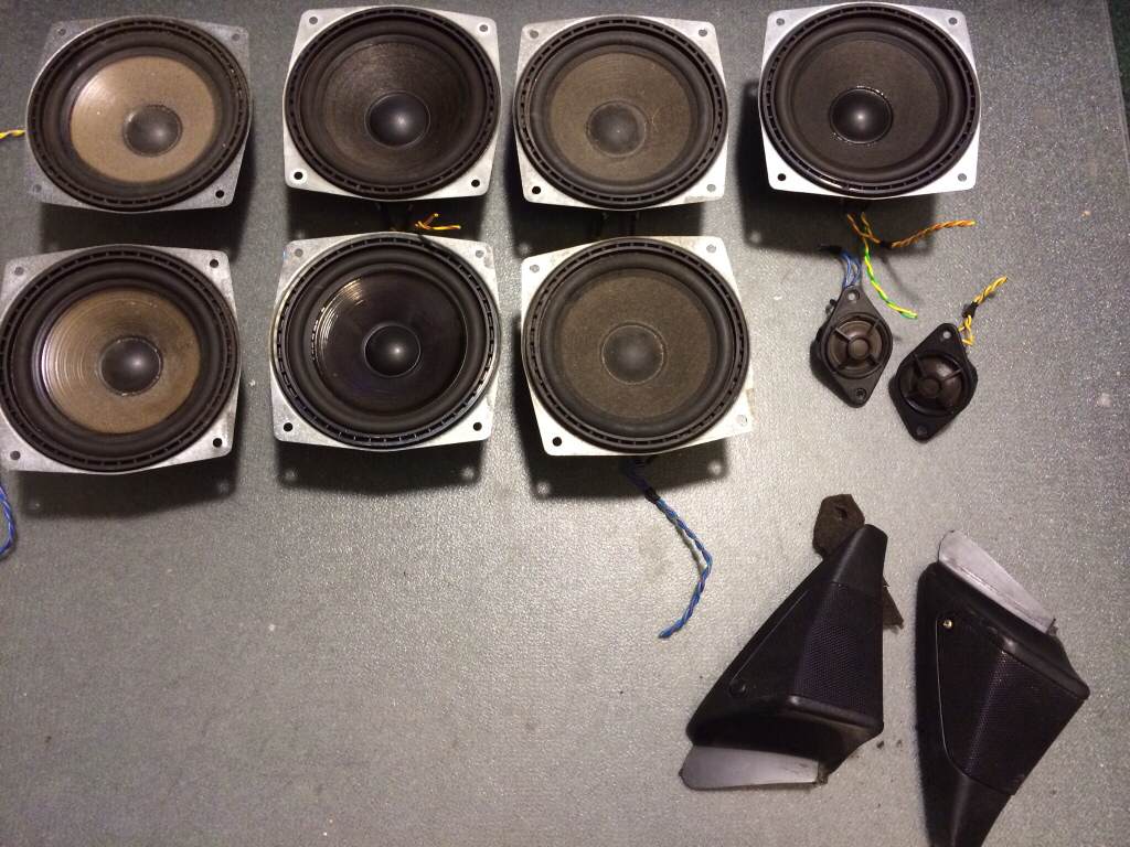

                woo hoo, all tested and only EDIT: twobad ones! The dead one is a mid, but it's kinda crusty anyway from a gross car so no biggie. And one front tweeter. Mid is blown VC and tweeter is blown cone.
                Looks like I'll be doing 3 way in front and 2 way in rear. when I find a second front tweeter. Now just wondering if I should buy a 4 channel, 5 channel, or just run my 2 channel on the front and let the deck handle the rears. I'd have to take the 2 channel from my sub though :/
