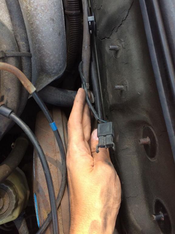

    I have found a bunch of unconnected connectors in car's engine bay. I have no idea what they could be for as the car runs fine. Just curious to know what would be there.

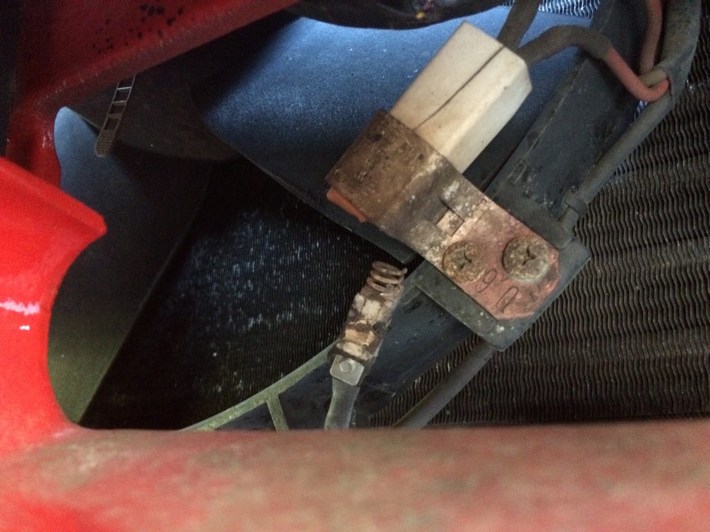

    Just options your car didn't come with or didn't need. The last photo that wire should be in the white thing. It is broken.

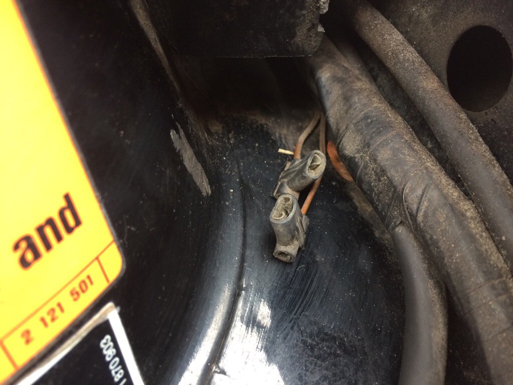

      What are they though? The white device connected to the fan is probably a resistor or something like that. I suppose I need to install a new one there. I still want to know what those other two might go to.

        The two wires by the strut tower in the first picture are for the factory alarm siren I believe. The second picture looks like it is maybe the brake master cylinder level sensor wire? Connector looks broken. The last picture is the auxiliary fan speed resistor.
