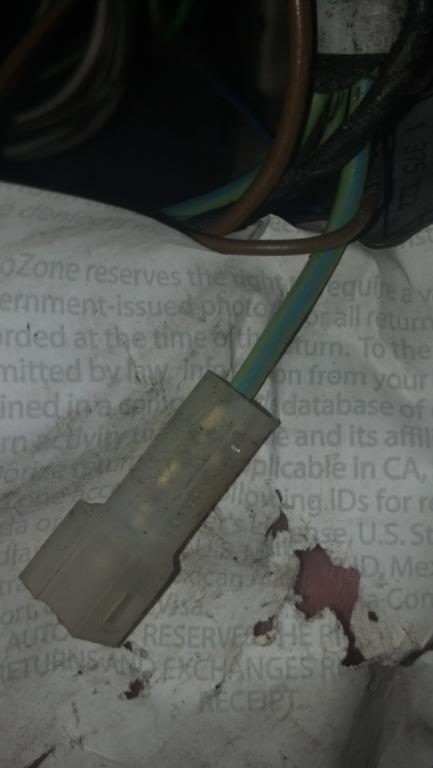

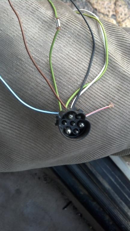

    could it be any of these following wires that I somehow left unconnected
    I am most suspect about the single green/blue wire I just cant figure out what it connects to
    I also cant figure out what this connecter is?is that left over from when I did the swap, or is it important, please help

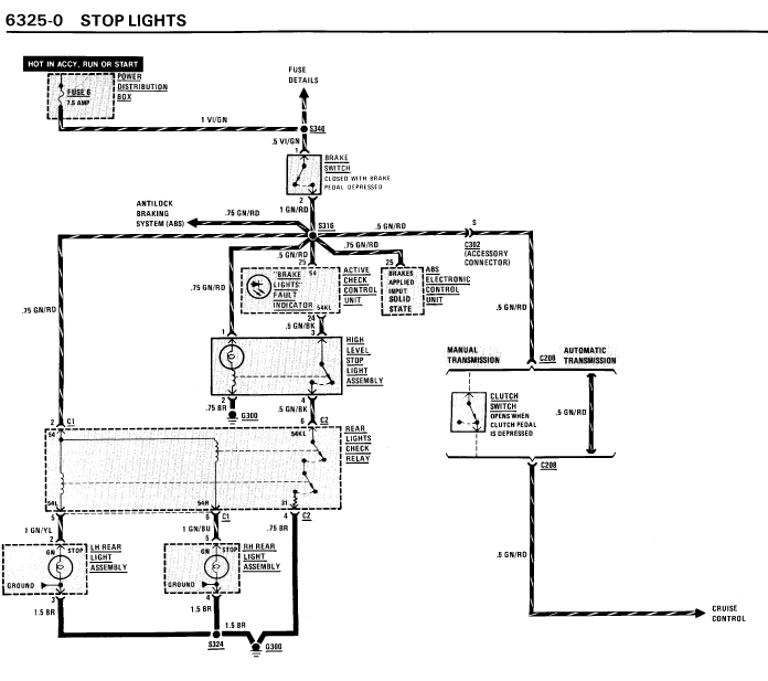

    download your ETM http://www.wedophones.com/BMWManualsLead.htm
    first off check the fuse #6 ,then follow the circuit and check power at switch(VI/Grn),thru switch(GRN/Rd) ,then at check control relay box (GRN/Rd)and then at bulb holder assembly (GRN/YLW left ,GRN/BU right)
