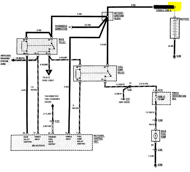

          • DaveSmed
            • Apr 2007
            • 1406
            So your connection is at the highlighted point in the print below?
            -Dave
            2003 Lincoln Towncar | 1992 BMW 325iC | 1968 Cadillac Deville
            Need some help figuring out the ETM?
            • DaveSmed
              • Apr 2007
              • 1406
              In that case, my recommendation is twofold.
              Obviously I would recommend moving over to a direct battery connection. Having a largeish inductive load in the power feed for the DME probably isn't the best path to a smooth running e30. Though not really that bad, its not exactly good either. You simply will see large voltage sags every time it kicks on. The electronics will probably manage ok, but the fuel pump will probably change quite a bit.
              That said, it sounds like there may be a marginal connection to your fusible link. Thats the kind of thing that leaves you on the side of the road someday. Perhaps troubleshooting the connection with the compressor connected there as a test load, then moving it over to a direct connection would be your best bet?
