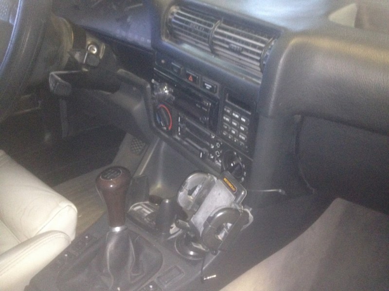

Pioneer head unit and my cup /phone holder solution:

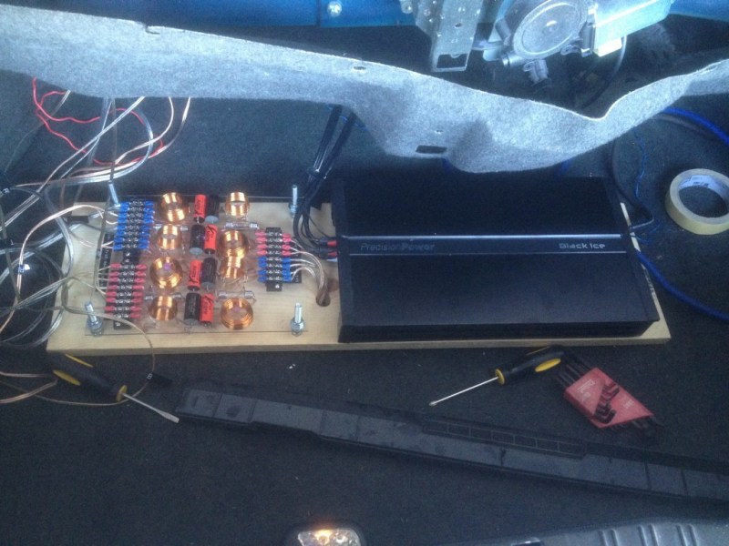

Completed crossover and amp board:

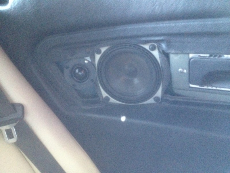

Rear Speakers:
Rear Speakers:
