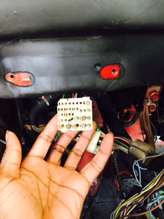

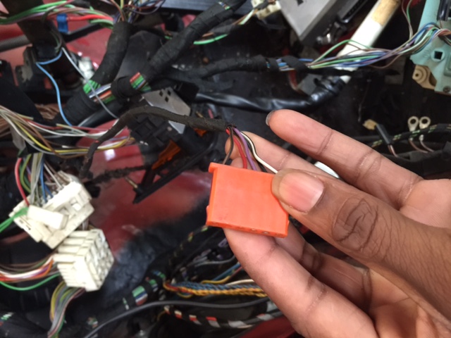

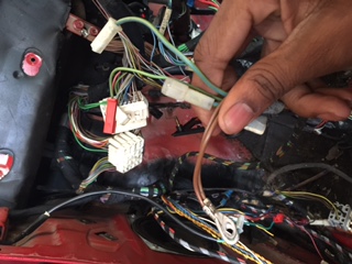

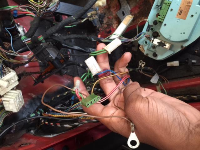

                okay here are the pics of some of the connectors

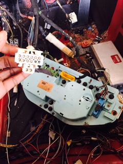

                      I can give you some quick feedback off the top of my head on some of those.
                      The big plug in "dashhelp1" is the C302 accessory connector. Brings in power (and maybe signlals, don't remember) for a bunch of the internal systems include the radio, windows, ABS, and cruise control. This connector should match up to the harness that leads to those various systems. Might be the only connector in the ETM that references the pins by letters instead of numbers. The bigger wires to this connector are the 30A wires that provide power to (I believe) the window motors and the sunroof motor, as well as the antenna and radio/amp.
                      The green plug in "dash4" goes to the OBC relay box (it's a black box under the left side of the dash). There's actually 2 green plugs that look alike that plug into that box.
                      The plug in "dash5" is the SRS (airbag) plug. Connector is C240, I believe. Mine has it, but I don't have airbags -- so it just sits there unplugged.
