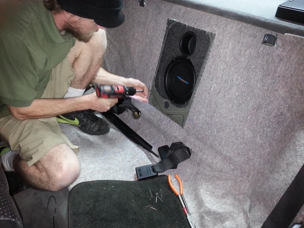

Here is Justin screwing the box in place:

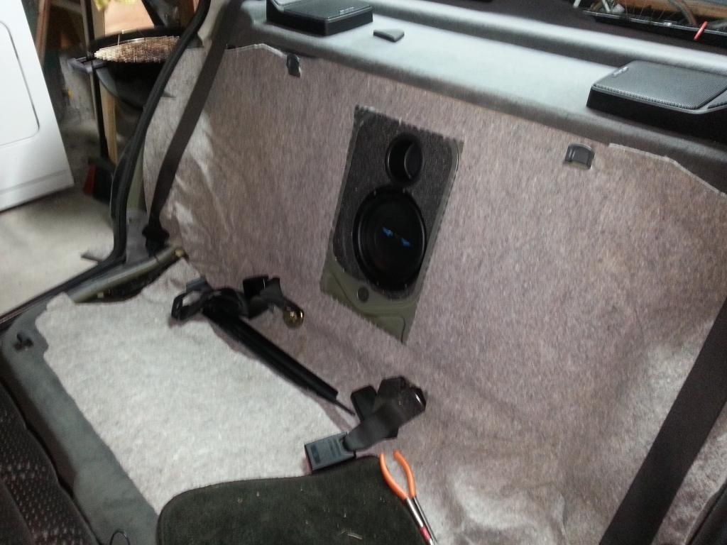

The pic is terrible, but the fit is obvious:

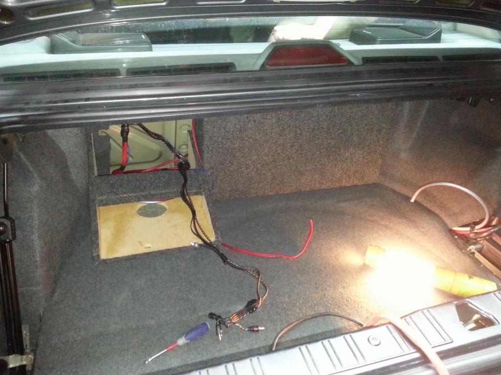

Here is the amp rack just before installation:
How this works is the same as any of the other E30 installs. The RCAs run down the left side of the car. If the car is premium sound, use the OE wires already in the trunk. Check out the "Killer $500 Thread" for that info, or if your car wasn't Premium Sound, you can "repurpose" your OE wires pretty easily. Ill get some pics up if needed.
