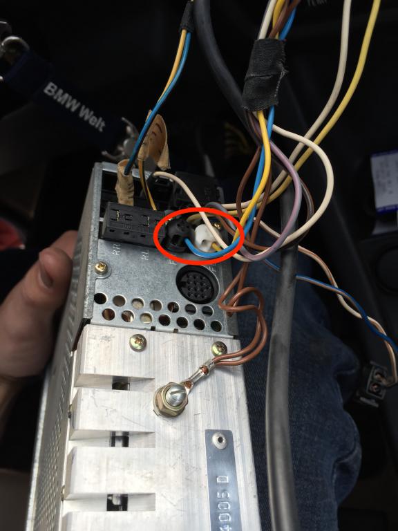

      I think it's something to do with the headunit. First off I noticed someone's messed with the head unit before, these two wires where swapped around. The wiring for the right side is suppose to be blue, while the left is yellow. Pictured in the pic bellow is after I swapped them to the correct sides. Also, when I swapped the two wires, the noise transferred over to the other side. I'm assuming its something to do with that specific plug in the head unit.

        If you swapped the blue and yellow and the noise changed sides, it's a bad deck.
