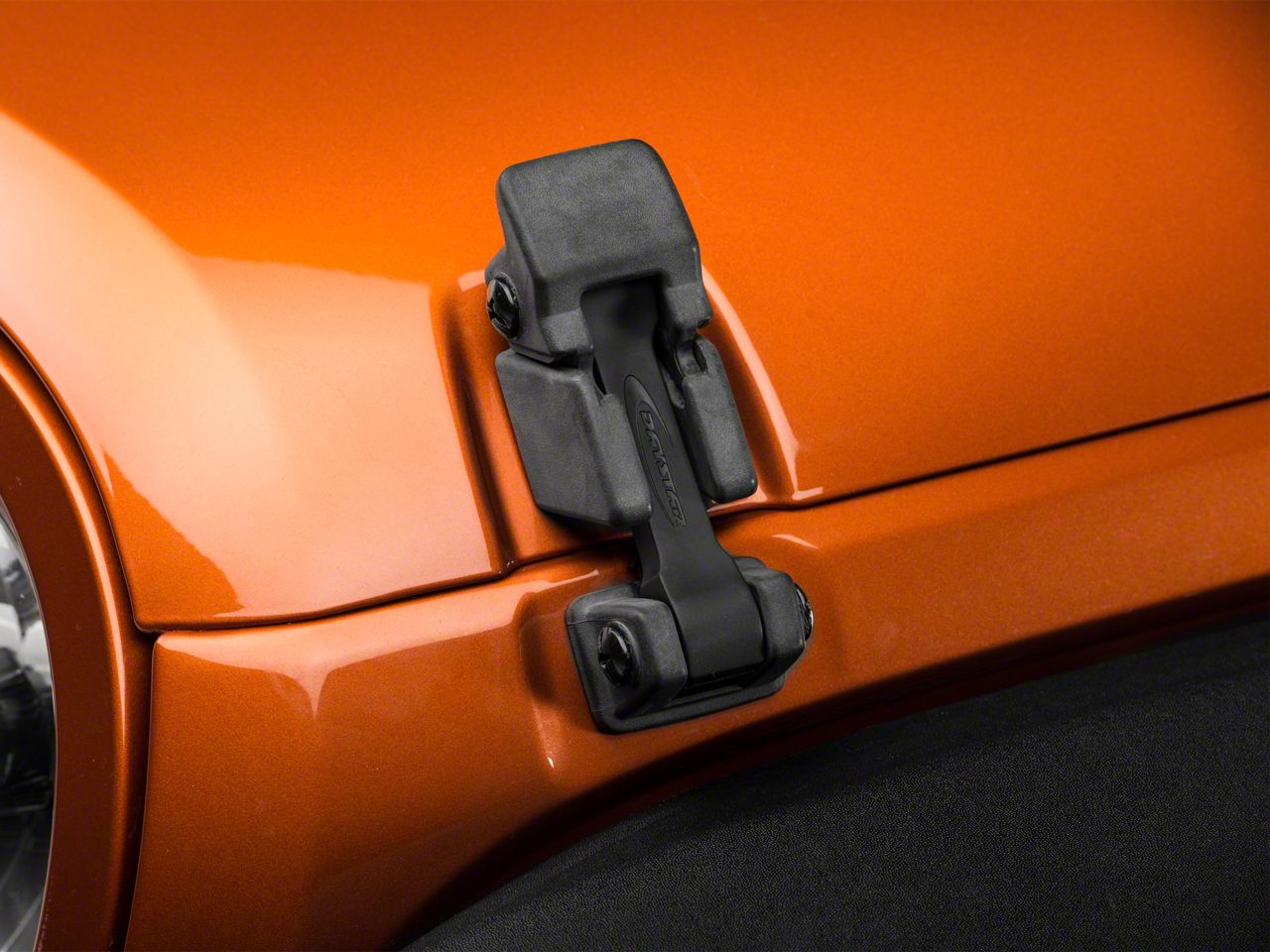

    Rather then using cheap drywall screws to attach it the car, I plan to use Semi-tractor trailer hood latches. They are made of rubber, and stretch over a capture - how much tension needed is up to you by the mounting distance. It it works for a 18 wheeler hood, it should work fine for a sub box in an e30 with the most spirited of driving.
