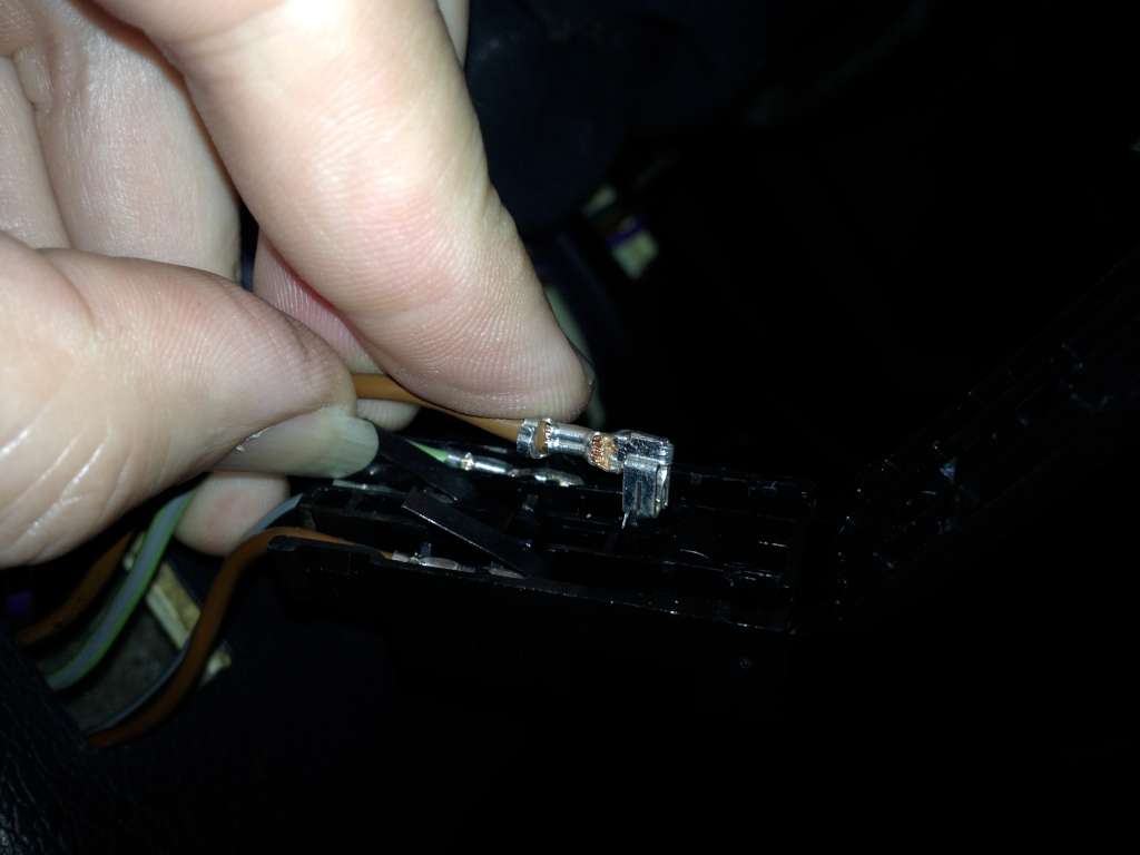

    I traced an intermittent power window problem to bent pins on the crimp-on terminals in the socket for the switch. I can't identify them on realoem. Can anyone tell me the part number for the terminal in the picture? Again, it's the terminal crimped onto the wires in the socket that the power window switch goes into.
    Thanks.
    --Rob Siegel

    Picture from the rear of the connector? Spent the last 15 min looking and couldn't find it either, but dammit now I/m on a mission to find it!!

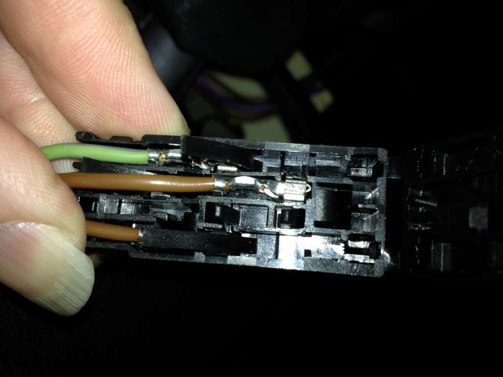

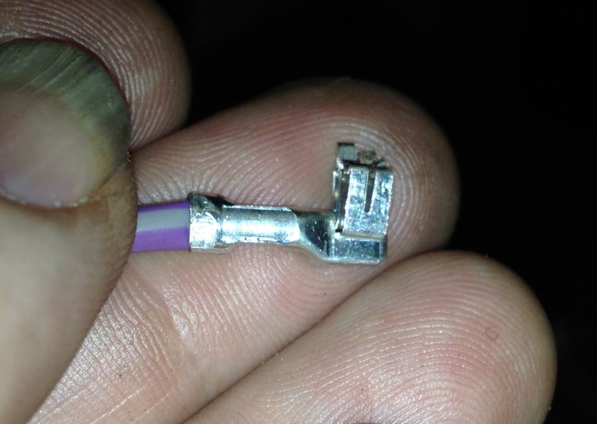

      Here's some more pics
      Here's some more pics, including the terminal being inserted into the back of the connector.

        Pretty sure those are called double leaf spring contacts, but I cannot find the right angle version that you have in BMW/Mini parts listings. Does that one have a "sheath" that's still in the plug?
        Best bet that I can see would be to get a straight through version as the socket has enough space beneath it to accommodate the change.

            Straight-in connectors won't fit. The connector shell has a snap-on back.
            I've bought a pair of "pigtails" (populated connectors with the wires cut off) on eBay.
