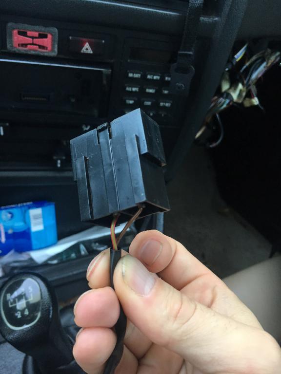

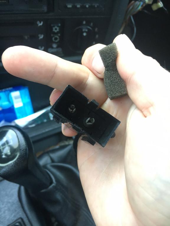

    Quiz nr 1 Clove Box (prob easiest one). This plug housing is in the glove box.
Name:	Glove box 001.jpg
Name:	Glove box 002.jpg

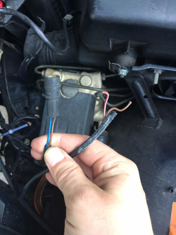

    Quiz nr 2 These loose wires were located under the driver side headlight.

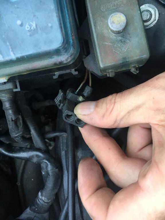

    These two went all together next to the fuse box where I found this loose plug. I think the other set of wires went under the steering wheel.

    first one is charge port for OE glovebox flashlight

      Cool thank you, first one down.

        2nd one is for outside air temp

          Cool thank you is it blue brown or brown red brown? if it's brown red brown. Any idea where the plug next to the fusebox should be going?

            The third one is a plug for the amti-theft alarm horn on early cars. On later cars they relocated the horn under a metal grille above the LH side brake cooling duct, probably to make it harder to disable. On those cars they left the harness pigtail for the early horn under the fusebox.

              Thank you so much, problem solved! This forum is the BEST.
