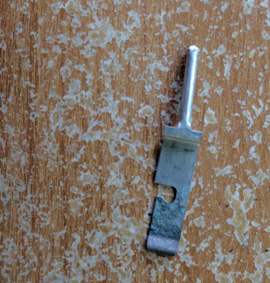

    I'm missing one of the bullet style pins in my front turn signal.
    I measured one of the remaining ones and got 2.53mm as a diameter, which I guess is about 10 gauge? Can't seem to find any 10 gauge bullet connectors around here.
    Anyways does anyone have any suggestions for a replacement piece?

      doh not in realoem. Here is what it looks like:

        heh a bent paperclip works....
        now i need to figure out why it is fast blinking when there aren't any bulbs out.

          You have any LED bulbs anywhere? My car has rear LED turn signals and it does the same thing.

            not on that circuit. No visible corrosion on the rears (i cleaned up that terminal after the picture).
